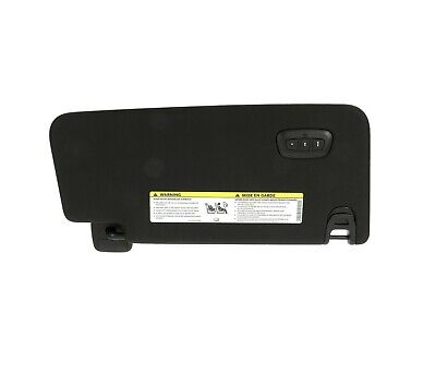

This has the Homelink and the illuminated mirror.https://www.mymoparparts.com/oem-parts/mopar-visor-left-7hd73tx7ac?c=az0yJnE9N0hENzNUWDdBQQ%3D%3D
Does anyone have a part number for the mating plug and connector numbers/ Source (maybe Mouser)? It doesn’t have to have the wiring, as in my picture. Thanks

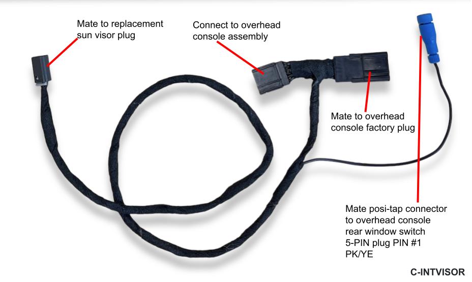

I added homelink to my dads 2023 big horn using factory parts, all plug and play and total cost of $150. I made a thread on here about it recently.
can you share us the link here please.
