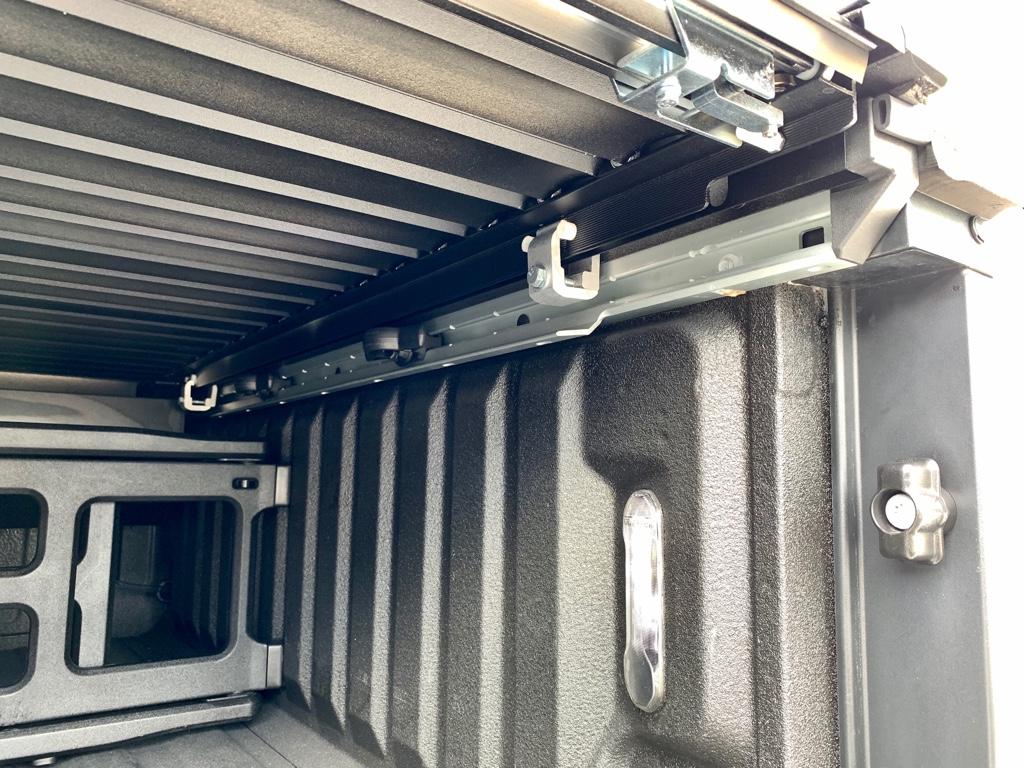

The best advice that I could give on installing these covers is to make sure the factory utility rails attached to your truck is lowered as low as they can be adjusted down. This will not fix all the issues with the covers. But it helps Rambox lid opening and the seal that travels down the lids.

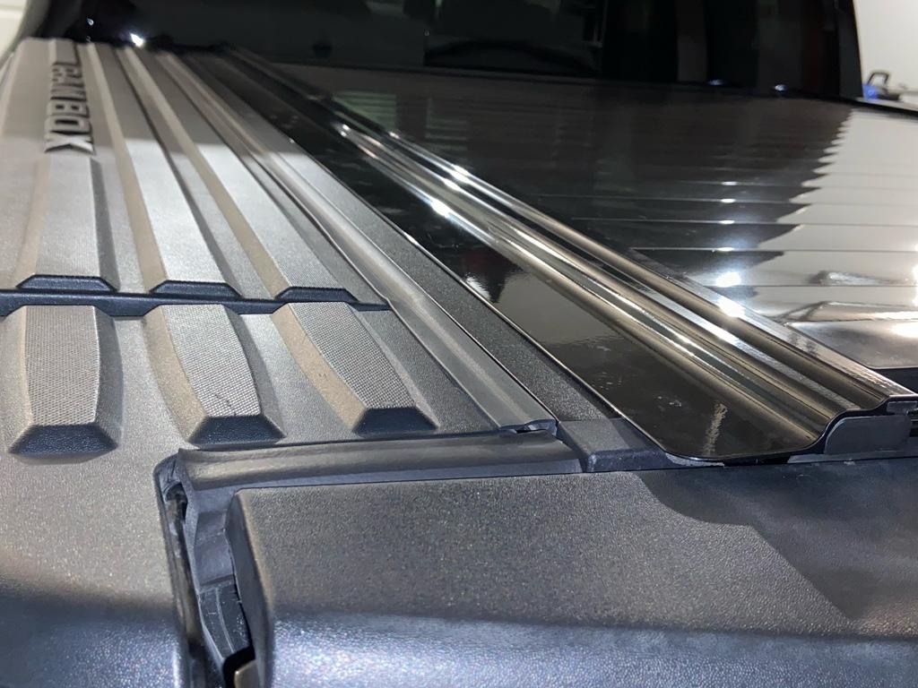

Do you think these rails might help with some of our problems. they are on a RamBox with the factory tonneau cover. You would not need the rails they sent. But it would not help with sealing anything . But it might help getting the tonnean to the correct level.View attachment 14425

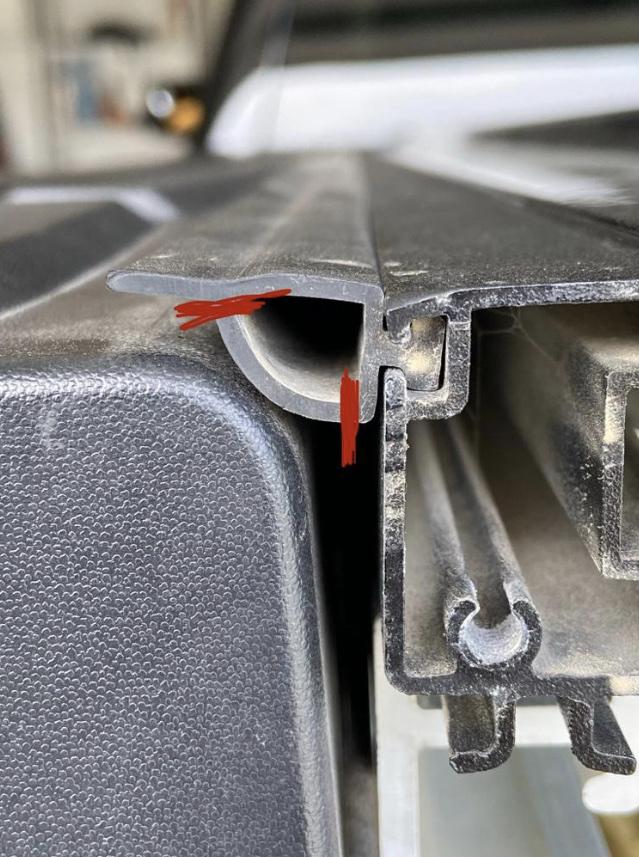

I’m not the author of this thread, but installed a Retrax MX which had the exact same issues with the Ramboxes as explained above. I just lived with it for a couple of months but felt like the Rambox use was limited so much by the cover that we stopped using them... they wouldn’t fully open without feeling like I’d completely damage them.
I ended up pulling the weatherstripping out of both Retrax channels and trimming off the triangle portion. Actually I believe they now seal better than before and don’t cause any interference noises.

One above showing the piece I trimmed off. Here’s how it sits on the truck now.

There is still interference from the gasket, but I’m able to open the rambox lid fully and easily without popping noise. It may not be perfect, but it’s much better than the Retrax gasket design.

I cut that triangle off of the entire length of the weatherstripping. With the triangle, I found the seal didn’t sit flat against the bed anywhere, removing the triangle helped to lay it down.
I’d say it still isn’t perfect, but a whole lot better than with the triangle. I used to have significant interference and if I pushed against it I could open the Rambox fully, but if I did, it would make an audible “pop” as it shut the lid. Not good. Now with the triangle removed I can feel the lid compress the seal, but the lid opens fully and there isn’t a pop sound when closing.

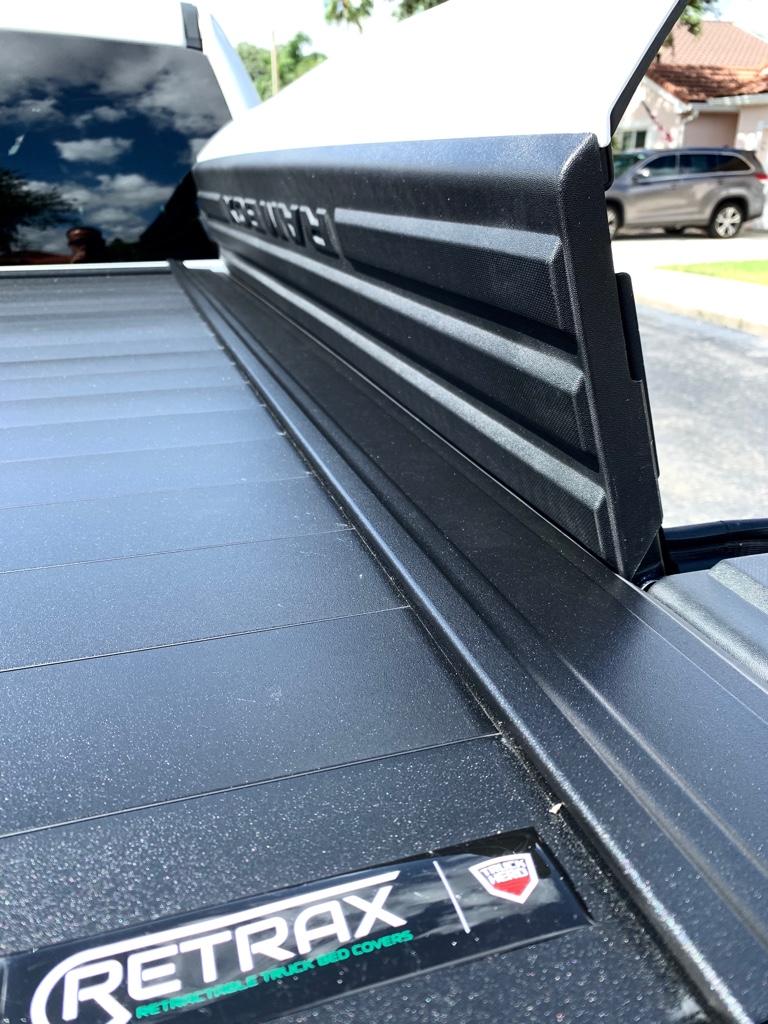

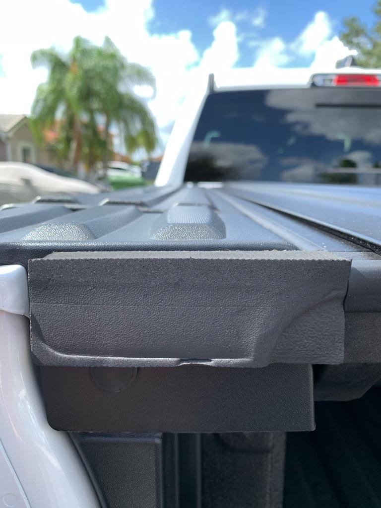

I must have an updated version of the side rails. On mine, I actually had to raise the OEM silver aluminum rails a tad bit up so that the Retrax side rails were sitting flush with the Rambox as the instructions suggested. Here's a photo of the cover / side rails. Keep in mind, this is the manual version and not the power version (PowerTraxPro). Mine is the Retrax MX Pro.
View attachment 72992View attachment 72993
Can you take a pic with the tailgate open looking at the end of the rails. Can’t tell exactly what’s going on here, if anything is different. It looks like you don’t have the overhanging gasket at all in that picture.
Any interference with the Ramboxes?
Maybe they made a fix?!
Also, where did you get the 1” thick foam gasket at the tailgate?

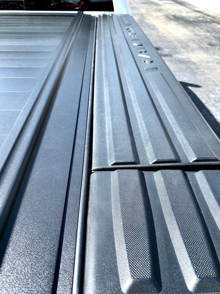

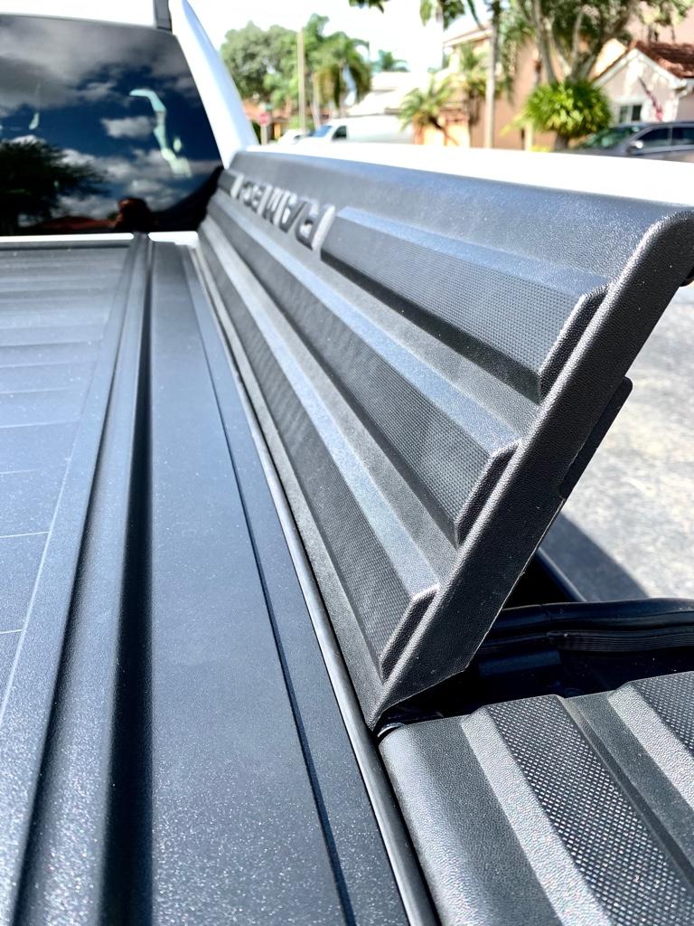

Correct, the gaskets appear different on the outside and don’t overhang. There is absolutely no interference with the Rambox system. I took two photos. One is the box partially open and the other is fully open.
As for the foam gaskets, my installer gave them to me so not quite sure where he ordered them from. It’s a high density type foam with an adhesive backing. They are about 4 1/8” long and about 1 1/2” wide.
