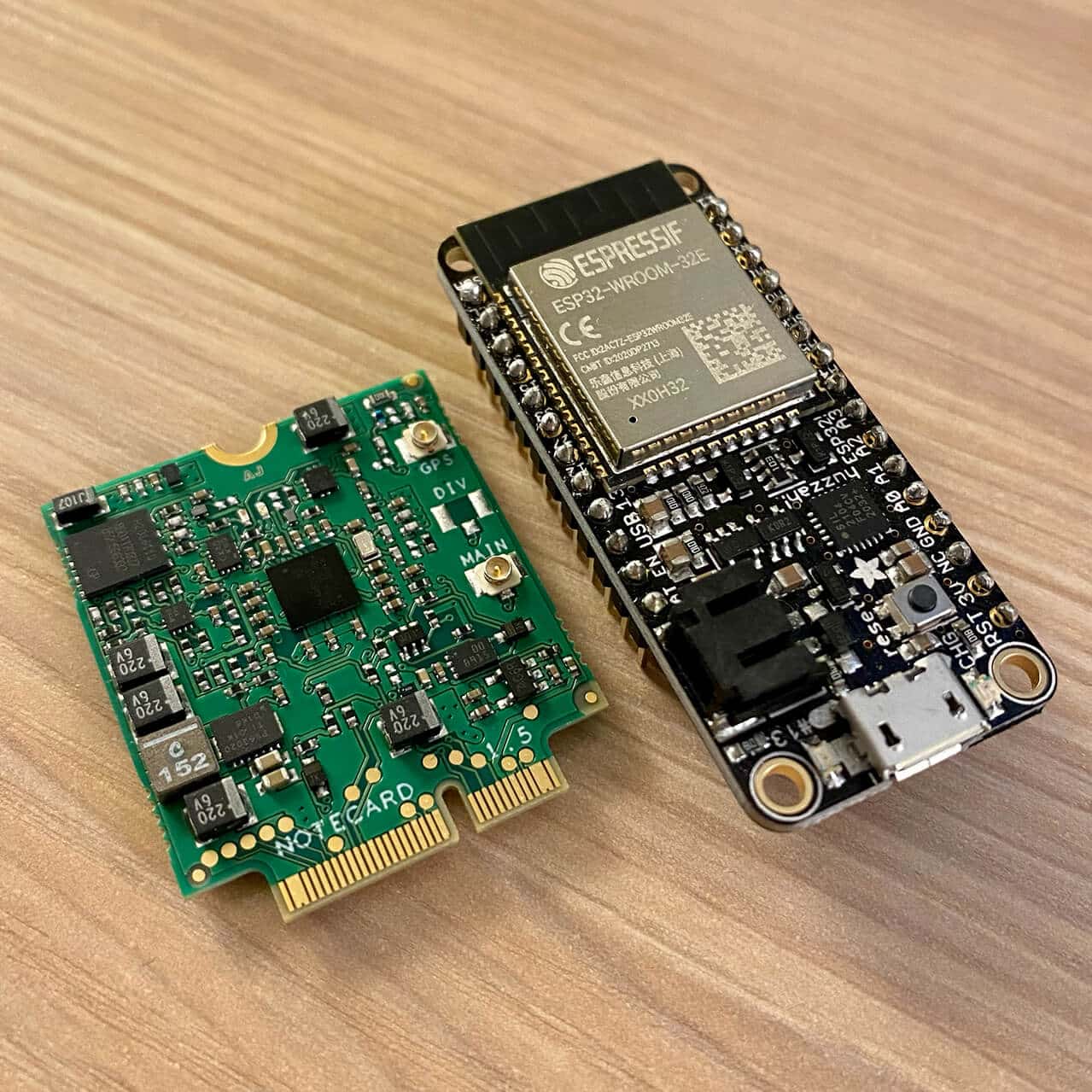

I drive a 2019 Ram 1500 limited. My work truck is a 2022 F150. The F150 let's me remote start from an App without a monthly subscription. I can't justify paying for the Ram subscription just for remote start. I can build something that can hack together a ram keyfob and "press" the remote start button and add it to my cellular plan for only the monthly cost of data used (less than $1 a month). The plan for my device would be to completely disconnect the battery from the fob until I need to trigger the remote start button. I could also gain access to the unlock/lock buttons this way. So here's my question:

I bought a fob on eBay just to add the tailgate function. Cost was around$30. As far as functionality it’s as good as my other fobs, but lacks the ram logo on the back and the icons are starting to wear on the buttons. But for using it for a project like you are saying it would be ideal. I have a programmer for this so it was a low cost upgrade to me. What kind of interface are you going to use for the cellular signal to trigger the remote? I was considering something similar using a particle electron board and relays, but never got around to actually doing it

Looking at using an ESP32 device and triggering buttons and then monitoring a 12V signal that is only on while the truck is running. This would give me a small amount of feedback that the truck started successfully. I'm sure I can get more technical feedback but I want proof of concept first. I'll program wifi networks first (My home and work) and then I'll move to the cellular connection using this:

Keep me posted if you get that running. I’ve been looking for a free cellular solution since the range on the remote isn’t ideal for starting from the office to the parking lot and I’m just too cheap to pay for the factory app
