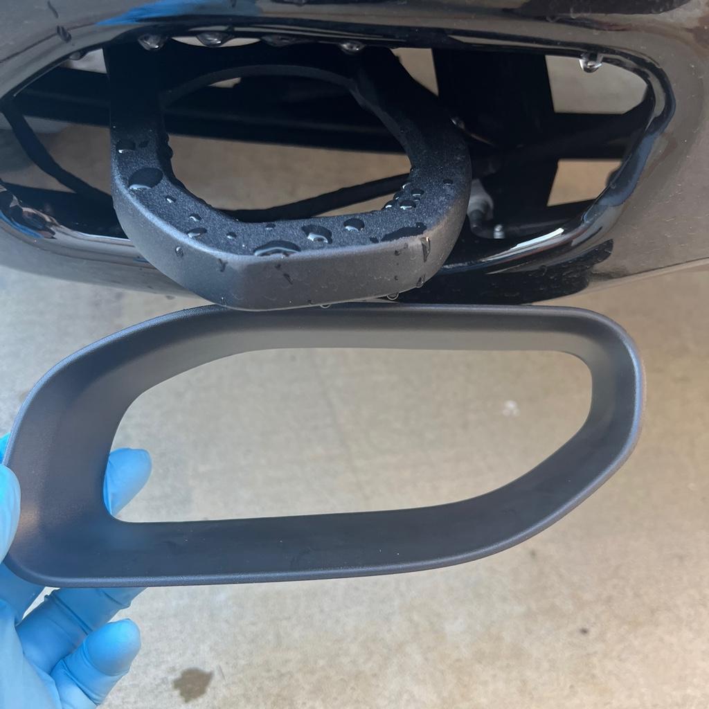

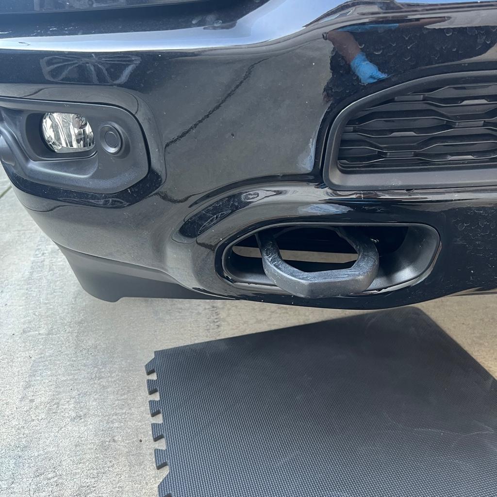

Welp, was quick and easy. Oddly enough it doesn’t look like it was damaged so much as it was bumped back. unfortunately my bumper had some light damage.
