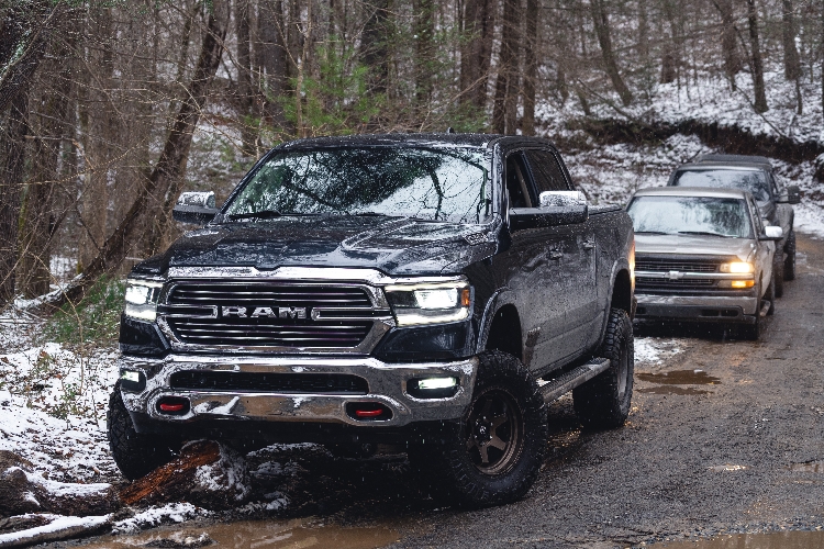

I left the bezels alone cuz they are still pretty tucked in and puts more focus on the hooks. It's not professional but turned out awesome. Here is mine.
Looks great man. Now that I see yours, I’m liking how the chrome makes the hooks stand out a little.
Owner of a 2020 Ram Laramie, 16 Dodge Charger scat pack and my wife 21 Jeep Wrangler Unlimited Sahara
I was iffy at first because I never saw a lot of this combo. It was either red on black face or red on body matched face. I am really happy with how they turned out, and yes, having the chrome really draws the eye to the hooks and I love that!

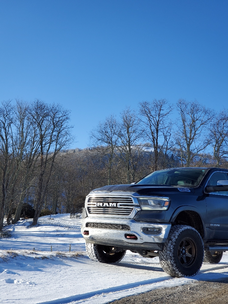

They look good, but to me the chrome bumper tones them down a bit. A painted bumper makes them pop more to me. I've posted this pic before, but here's mine shortly after I painted them last spring...
