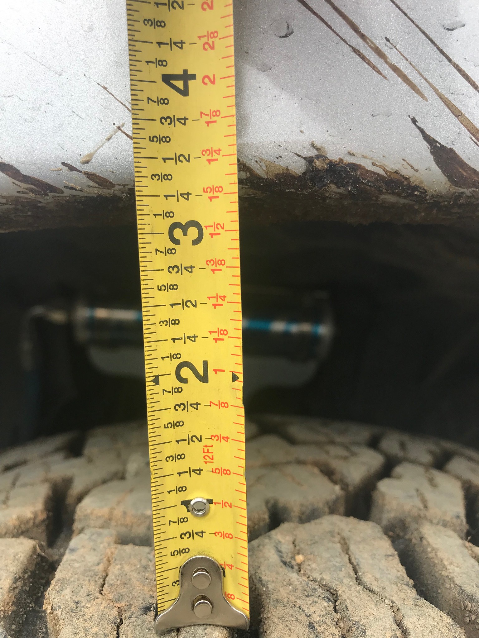

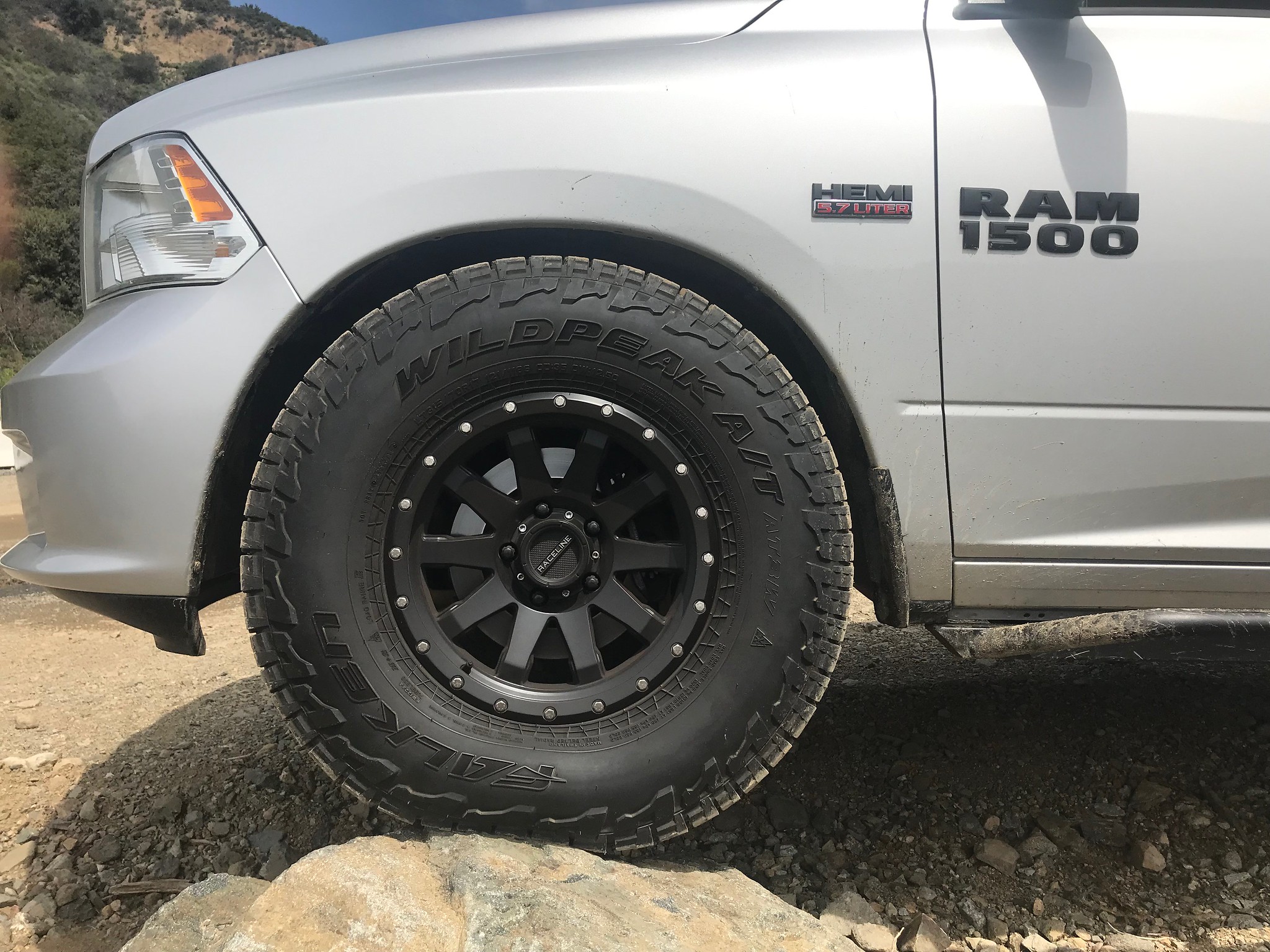

Front off you will gain up travel and It tends to further smooth out the ride in the dirt since you're literally honoring the independance in your IFS without the sway bar. I did remove mine for testing offroad and the difference is very noticeable.
As expected I like the handle better with the sway bar on.
With sway bar on, 315/70/17 tires and King CO's, i have 3 1/8 gap between the fender edge and the tires

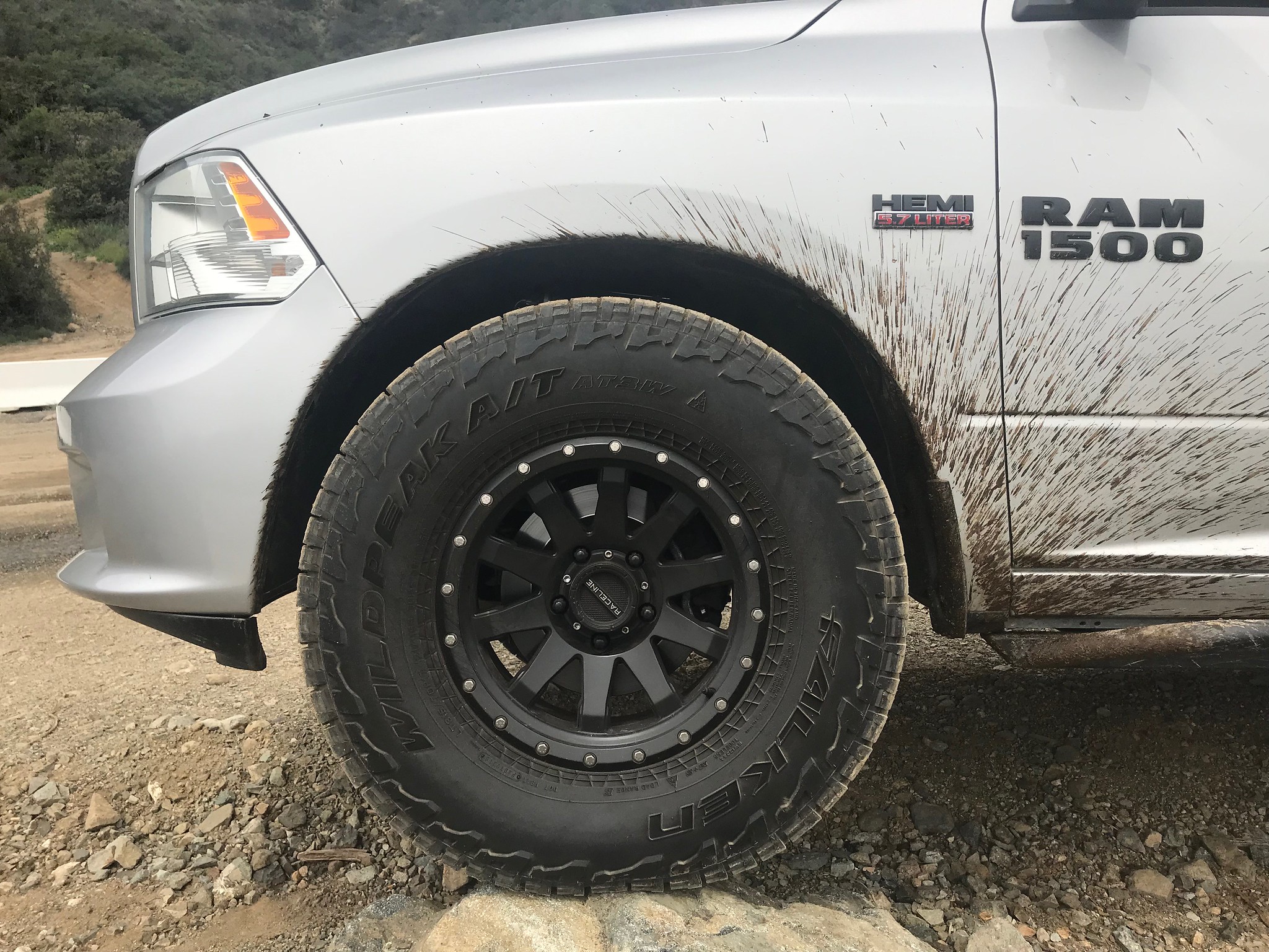

With the sway bar off, that gap closes 1.5" so now the tires sit at 1 5/8", keep in mind this is with the truck sitting in the CO bumpstop. i'd expect that bumpstop will prob close another 1" or more on a big hit, so you have to account for that as well if you want the tires not to kiss the fenders while running the truck hard. Measure your gap with and without the bar with your current tires and that will give you an idea where yours stand.

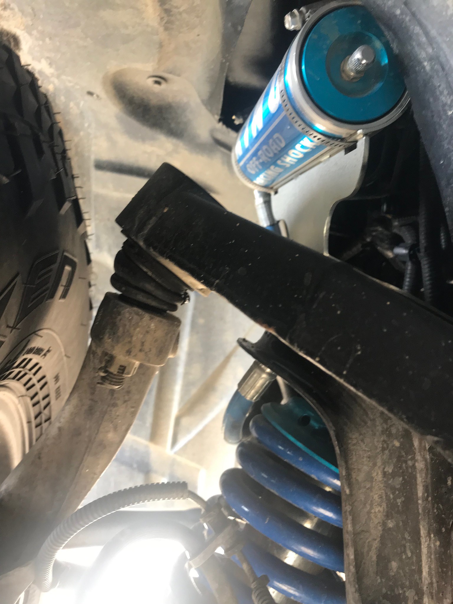

The Zone UCA BJ is maxed out without the sway bars, Icon Delta Joints or Uniballs will also allow more uptravel as the BJ won't max at this angle.

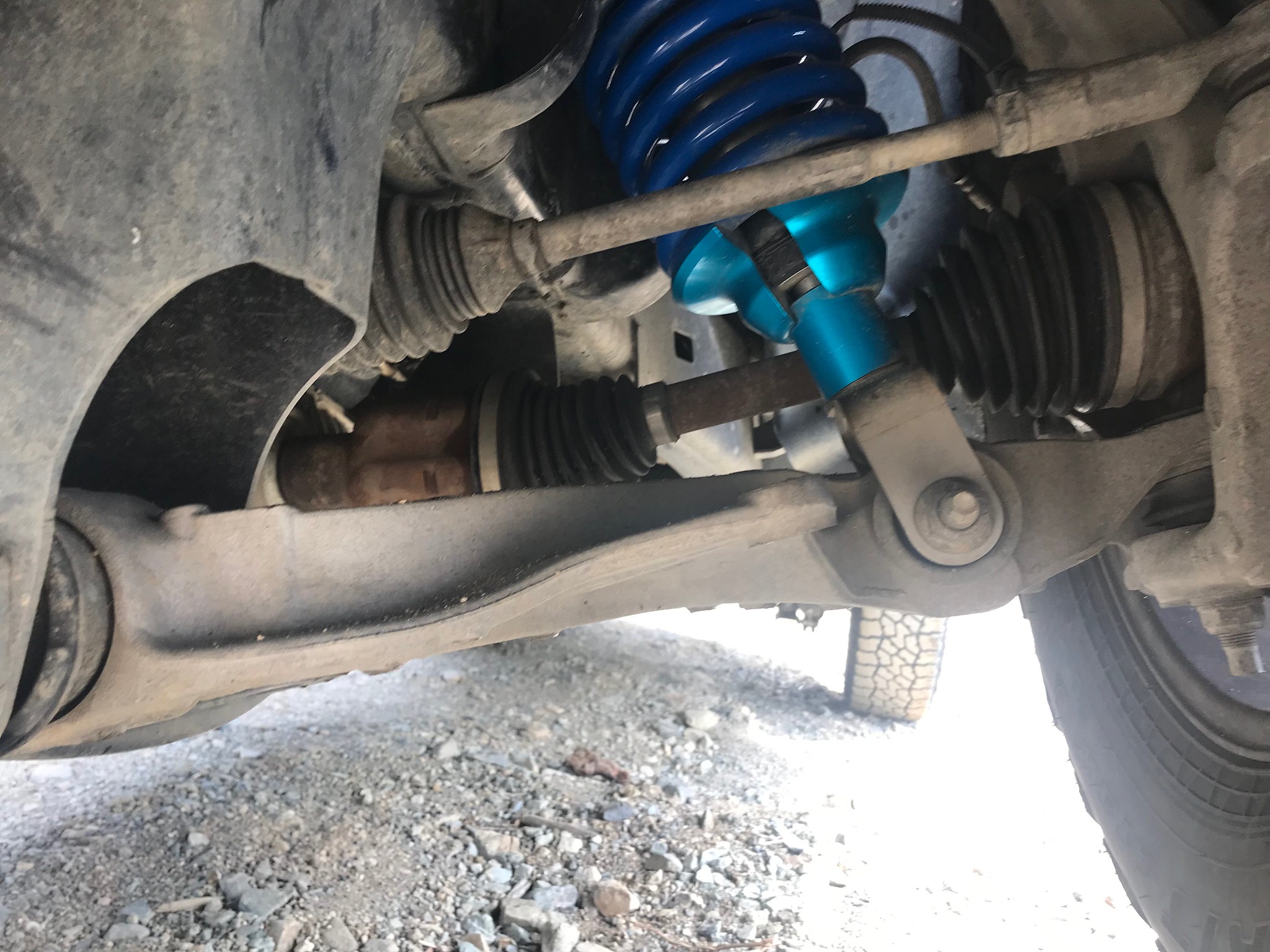

CV's are fine for the most part, this is the angle of the CV at full tuck without the sway bar so there is more room to go upwards if needed

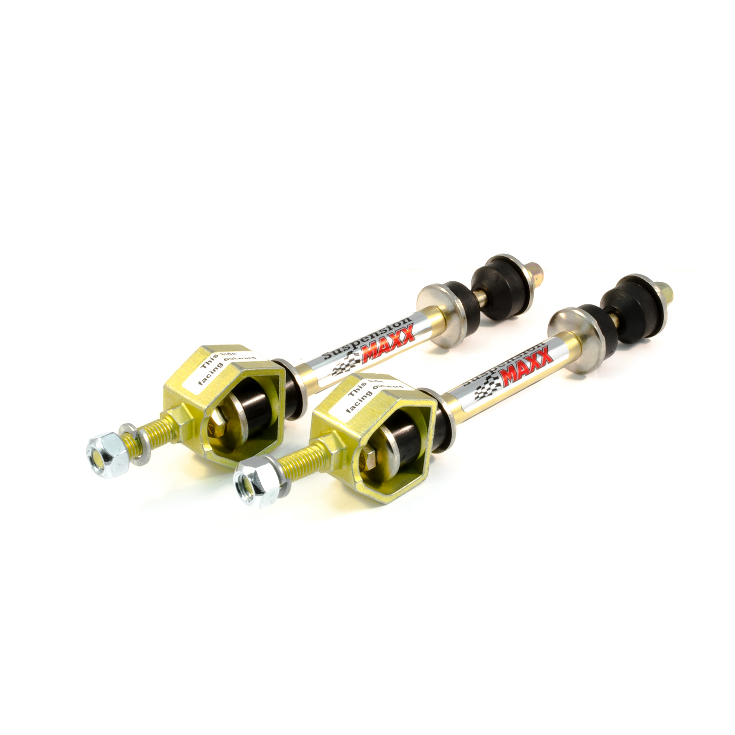

Since you have compression adjusters in your Kings you could set the front to stiff and help with the sway but I feel the precision/control in the way the truck reacts to steering input is better at speed with the sway bar on. Take it off to test and try it super easy to remove and super easy to install back. You may like it without it. I run mine with the bar on but i have longer front sway bar links. don't know if your links are the same as the ones in the DS trucks. if they're this are the Suspension Maxx links for 2-3" lift. 1/2" more uptravel in my case compared to stock lenght links with the sway bar on
