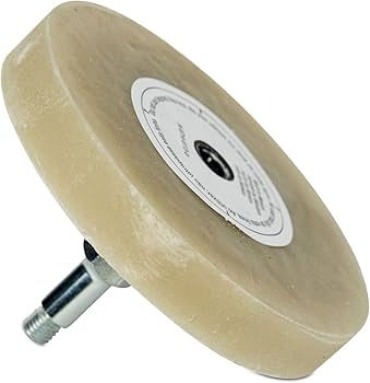

Remove the adhesive with a rubber eraser wheel
