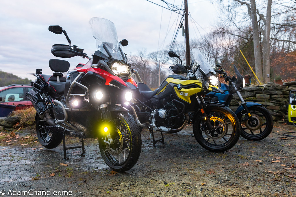

Not cruisers. all of my bikes I actually raise higher than stock since I'm 34" inseam off the ground with boots.
They're all pretty high off the ground:
Our bikes all range from 6 inches to 14 inches off the ground if I are to estimate. so no clearance issues expected.
