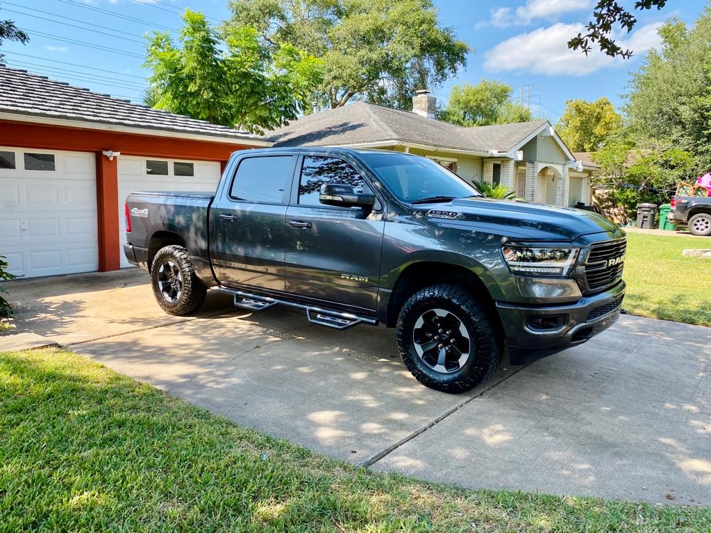

Confirmed weights this morning. Will post before/after pics after install this morning, as well as caliper fitment and suspension clearances when I get it done.
Ok so here are the results. I have a leveling kit and links, but I did not put it on yet. This is a 2020 Longhorn with air, and I have NO RUBBING at any height (even entry/exit), full lock both sides both ways. No cutting. They fit perfectly.
Decibel meter @ 45 and @ 75 were actually no different. Averaged 61-63db for both. Ride quality has not changed whatsoever, and I think the truck, because of the stiffer sidewalls, actually handles better than with the Falkens.
The only marginal clearance was on the calipers, which is well documented here. I had roughly 6mm between the calipers and the wheel so really no clearance issues there.
Clearance to the upper control arms, though I didn't measure it, is roughly the same, and almost indistinguishable as seen in the photo.

I apologize as the comparison photo for post-install is in entry/exit mode, not normal as the before photo was taken. However, this should be a good indicator for those that are worried that on stock suspension you can fit these tires with NO modification whatsoever. All in all I am VERY satisfied with the tires, and can't wait to take them off-road! Hopefully this helps someone.

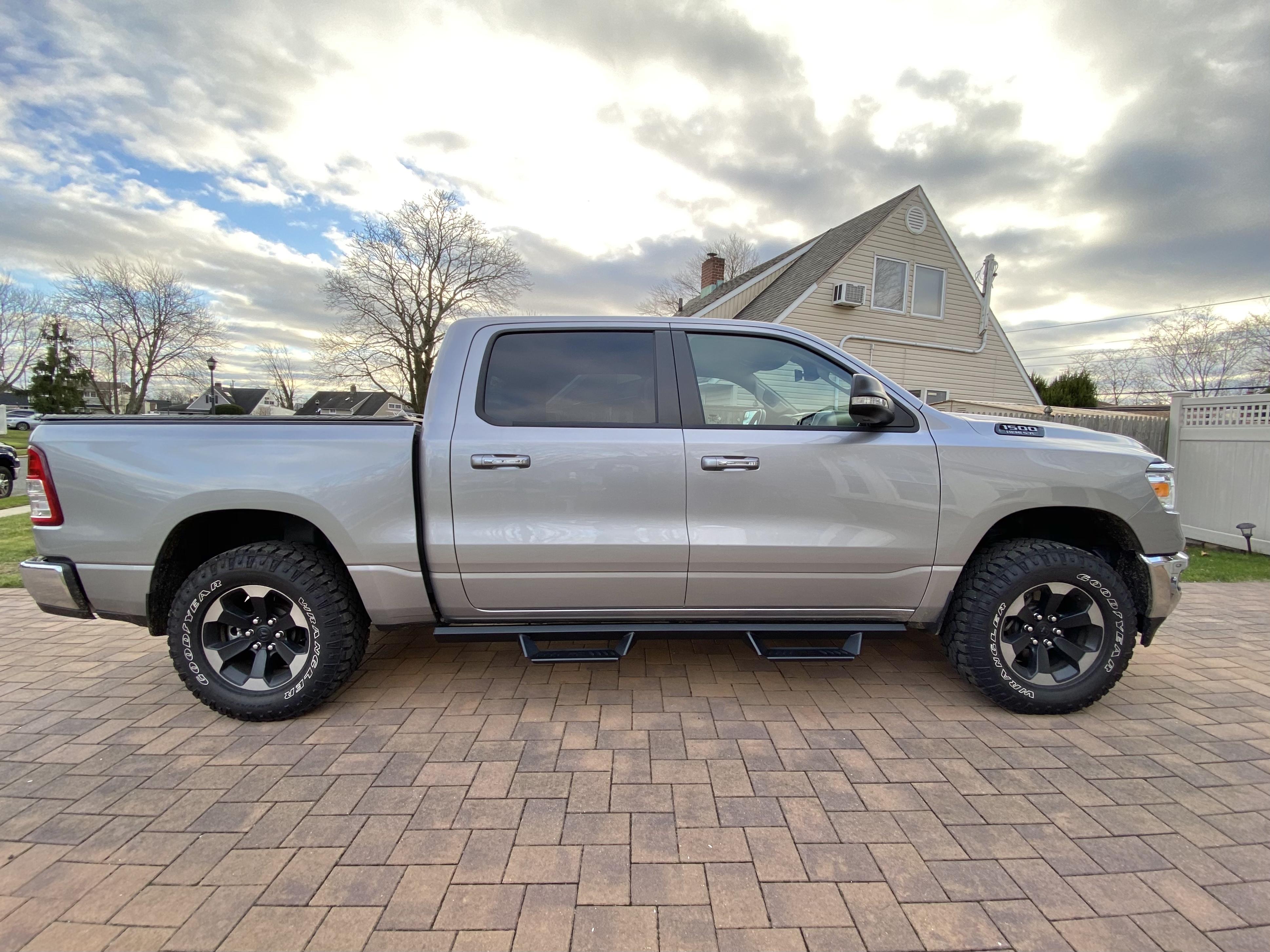

Please post pictures once the 295/70r18 Wildpeaks are installed as I am looking at pulling the trigger on those to replace my stock size Wildpeaks and wondering how they will look. Deciding between going up one size from stock to 275/70 or next available in Wildpeaks at 295/70. Also wanted to to check if you have your truck leveled, or just stock with ORP.
Here you go. I have ORP with bilsteins on notch 5.
Thank you for posting and great looking truck. I will probably go with same tires as I really liked my current set, but definitely need to go up in size from stock as they look ridiculously small for these trucks. Other than ORP mine is stock so hopefully they clear, but if not there may be some bilsteins in my future as well.
Mine clear with plenty of room to spare. You may have to do some minor wheel liner trimming if you don't level.

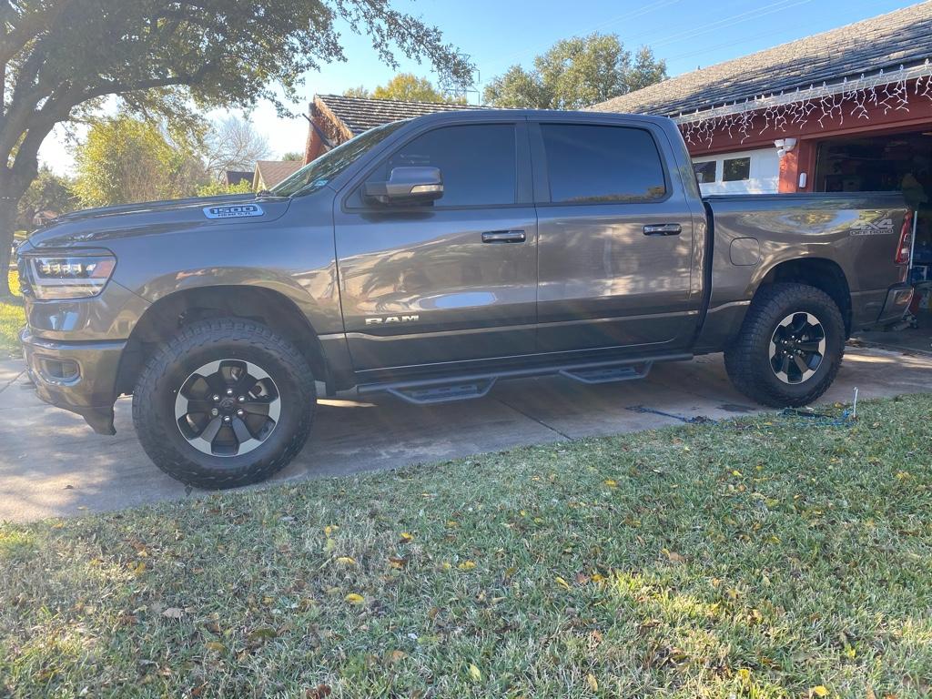

Thanks again for the information and now have the Falkens in the 295/70 18 ordered from 4wp since they have free install with purchase of 4 tires going on right now. However, I wanted to hit you up for additional information and see if you only installed Bilsteins on the front, or both front and back. Not planning to go there yet but I prefer that thought to the normal level blocks/pucks or whatever you want to call them should I have issues with tires rubbing.
I had a top hat spacer on the strut before I switched to 5100s. I have 5160s on the back but no rear lift. I switched to the bilsteins because the spacer caused too much down travel on the factory strut and caused it to leak.
