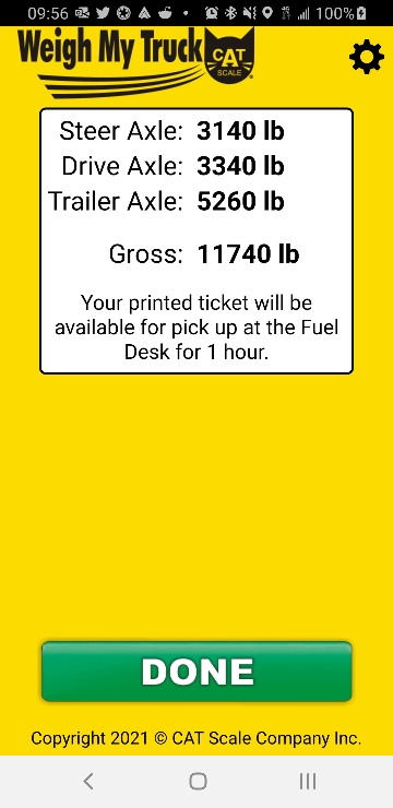

Here is a recent weight for me. 3/4 tank with trailer and some gear. I still have some payload left, but it is tight.
