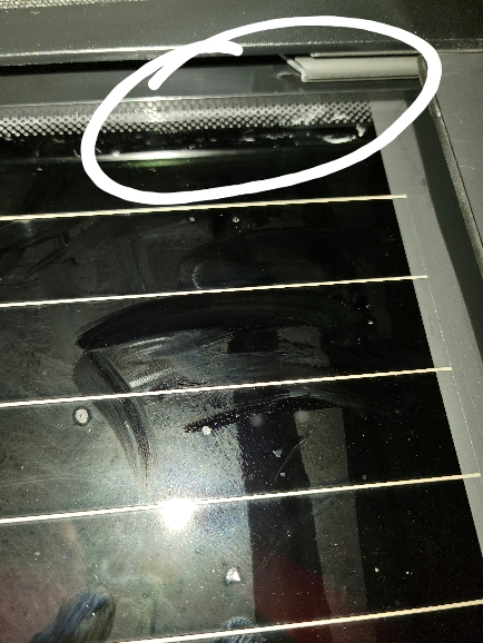

Add me to this massive list. Noticed the backseat was moist just under the headrest while buckling the kid into his seat. Then found the source. Didn't think to get pics before wiping them off. Noticed two drips coming over the sliding window track (?), seemingly from the headliner area. Later I found water coming between the glass and plastic in the circled area of the picture.
I thought maybe it was the third brake light, so I bought the recommended marine weatherstripping and installed it. Didn't solve the problem. Pulled the light off today and it was bone dry behind it.
I'll be calling the dealer tomorrow and relaying everything I've read here. Maybe they can do something about my warping ramboxes too.

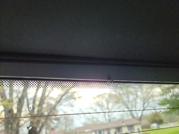

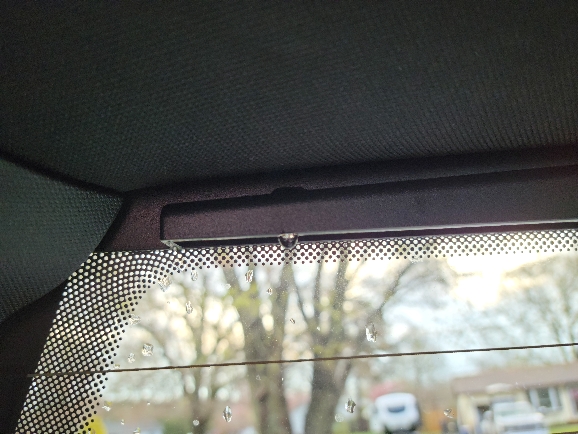

Got some pictures this morning. No obvious cracks. Seems to be coming from headliner area in addition to the area in the pic on my previous comment. Got an appointment to have the truck checked on the 8th.
