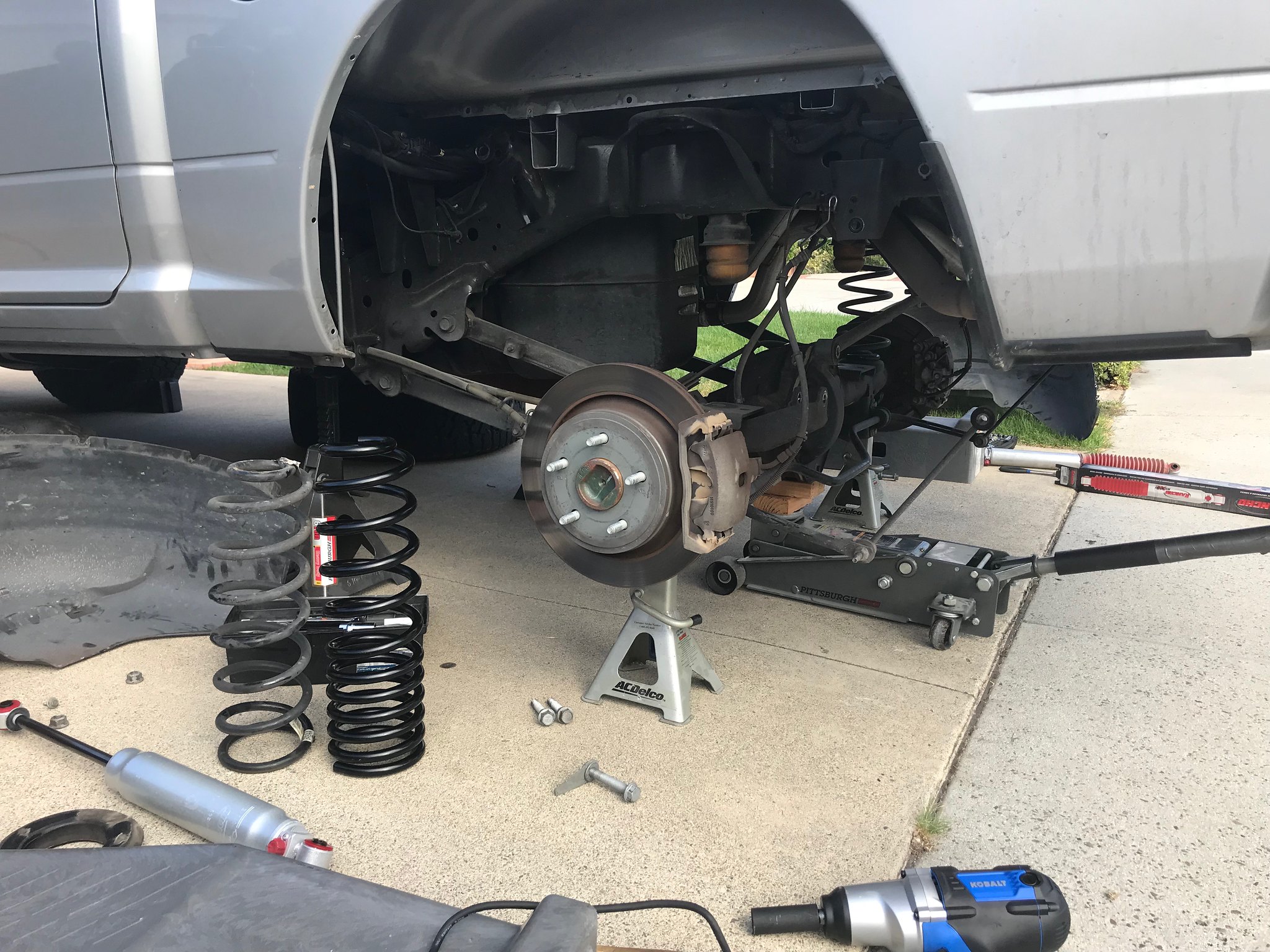

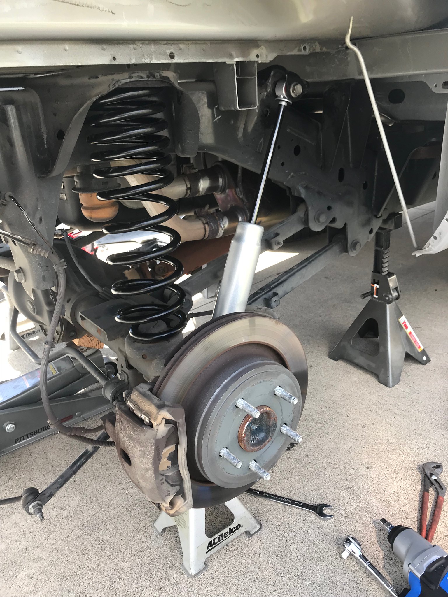

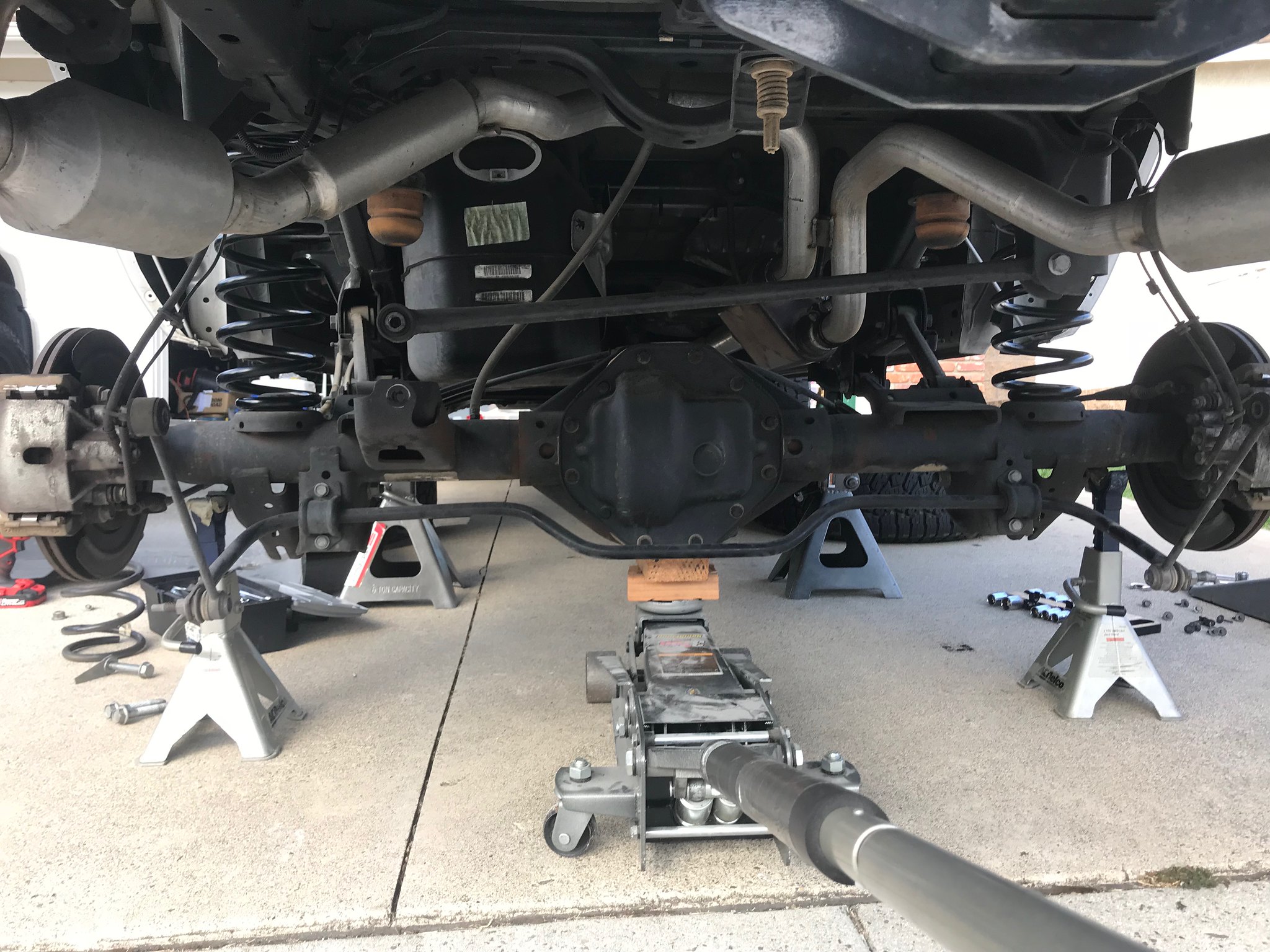

You want to remove the tension from the spring so you can lift from say the diff pumpkin but you want to support the weight of the truck by the frame to ease up on the weight pushing down on the spring. Way easier to take the spring out if you can support the weight from the frame as the axel can droop freely. 2 floor jacks will make the job a breeze, but you can do it with one and some jack stands. I have 4 floor jacks but the ones i use for my high clearance vehicles are from HF one is 3 ton standard, the other is a 2 ton low profile/hi lift (23 3/4"), the last gives me more than enough droop in my axel to take out factory springs without compressing them. (take your wheel off), with long springs i still have to compress them to make the job easier. and that's even disconnecting the rear trackbar.
Hopefully this gives you an idea
Untitled by RAM RSM, on Flickr
