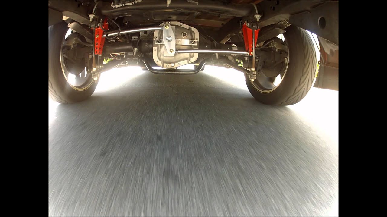

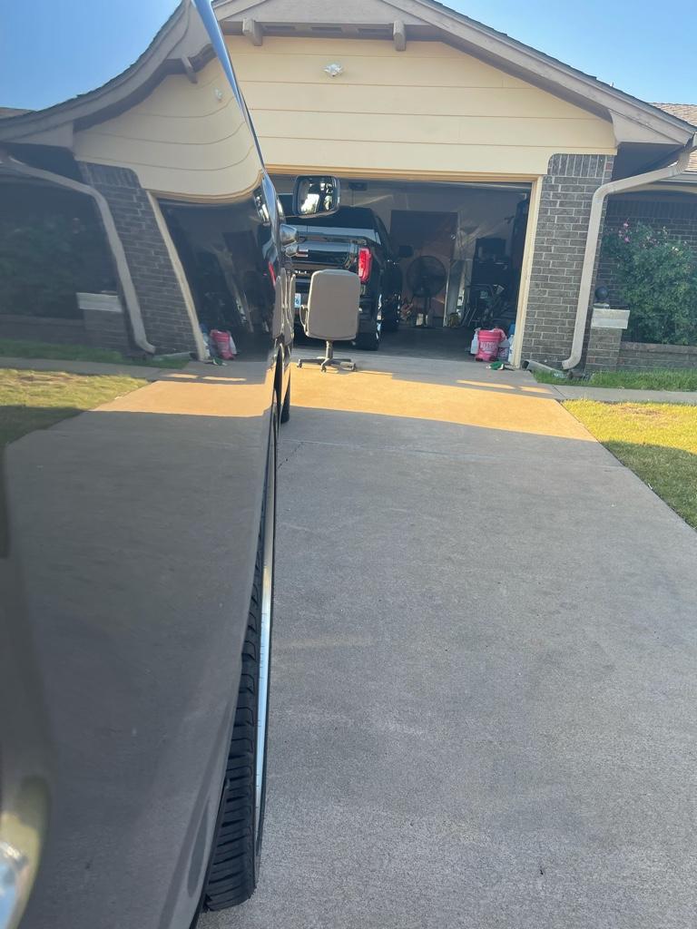

I have the Max Trac 2’ 4’ drop on my ram. Recently installed billets on the truck. Noticed the driver side poked out more than the passenger side. Raceline told me to measure the wheels from the center to make sure they didn’t mess up when making the wheels. All checked out well, I guess now we have to find out why it’s sitting this way. Pictures below

Did you change the track bar? If you changed the height of the truck without changing the track bar this can happen. Might need an adjustable track bar. This happened to me when I replaced the track bar on a Jeep Cherokee XJ. The Jeep had the Up Country suspension, which sat slightly higher than stock. I installed a track bar for the standared suspension and the axle was then off center......

It's simple geometry. A is the height difference between the axle and the upper track bar mount and B is the horizontal distance between the two ends of track bar, and C is the hypotenuse which is the track bar. If A gets smaller and C remains the same, then B has to grow. And when yours grew, it pushed the axle to the side. If you had lifted the truck, the other side would be sticking out. Buy an adjustable track bar

This. If you are changing your ride height dramatically you'll need an adjustable track or panhard bar. Personally, I think the watts link is better than both as an adjustable track bar only keeps the axle centered at the desired ride height but still allows movement horizontally in both directions on up and down movements whereas a watts link keeps it centered through the suspension travel

Did your kit have all of these components? This is the MaxTrac Suspension K332724 kit, it includes the track bar (panhard bar) relocation bracket shown in the center of the photo. The kit also include shorter sway bay end links.
