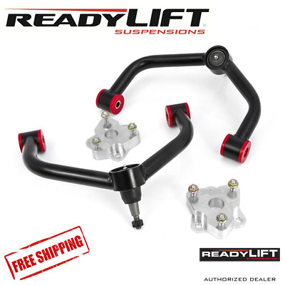

So i just ordered readylift uca for my 2020 ram 1500 with 2” leveling non orp i am wondering how good these arms are and if anyone can post there angles with them
I’ve been considering a 3” Motofab puck up front with these UCA’s and a 1.5” Motofab puck in the rear. I’d be curious to see what the angles are with a 2” puck vs a 3” puck with these UCA’s

All of the Readylift UCA's I can find say they fit a 2006-2018 but don't fit 2019+ according to the website. Are these the same ones you have and they ended up fitting anyways?

I plan on putting bilstein 6112 top setting on shortly. I already had the ready lift 2" level kit with uca from a friend for a few hundred. Is the angle right on the RL uca for the top clip on the bilstein?
