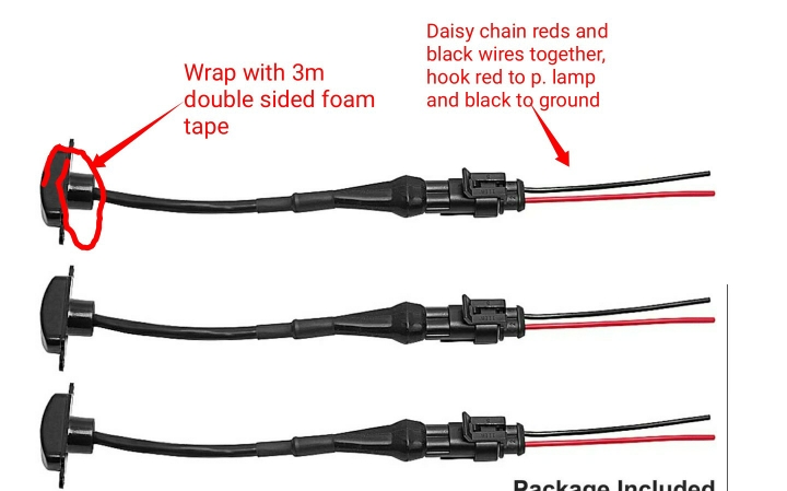

Can you describe your install and how you wired them?
Wire is positive to parking lamp and negetive to ground. I don't care for splicing into oem wires and honestly to get to wire on the back of the headlamp was just a pain so I chose just to run the positive wire to the back bumper where I installed curt trailer harness adapter and spliced into the parking /rubbing wire of the Curt harness. I know it's the most ideal wiring location but pretty easy considering you have ample room underneath. For the light install in to grill I wrapped 3M double-sided foam tape around the barrel(you are just building the barrel diameter so it is a hair larger than grill opening)of each led light and then insert into grill and the double-sided tape secures them to the grill. They may appear a little loose(thjs is good as it gives you a chance to adjust) but give it overnight and foam tape will re-expand(it pushed down slightly when inserting into the grill) and adhere to the grill. The wires or each light are daisy chained together behind the grill. Word of caution be careful running the wires behind so they don't interfere with grill shutters. I also removed the screw tabs off the sides of each light cutters and sanded flat with dremel.
