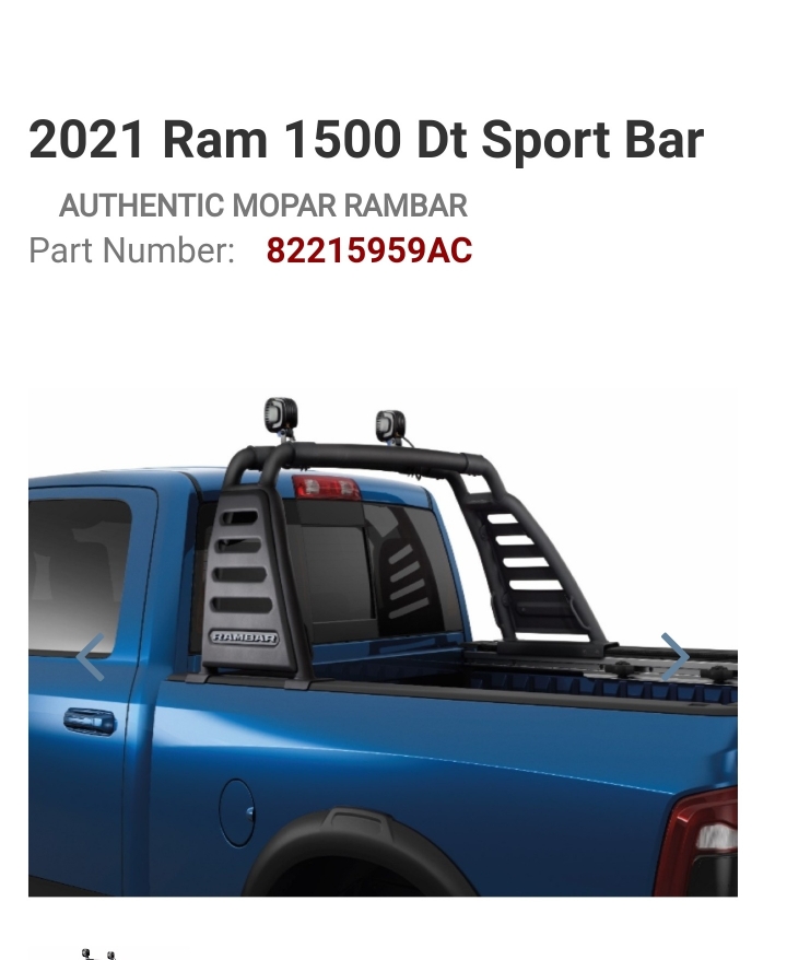

does anyone know if you can order this standalone, is it compatible with tech package,(camera for rearview mirror) and BAK revolver x4s cover. Thank you!!

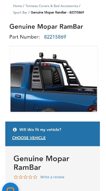

Part# 82215869
You can order from any dealer

That part is listed for the 2500 and 3500. 1500 is not listed. I should have explained myself better.
For the 2022 Ram Rebel, there is the off road group that comes with the rambar and all the rebel graphic decals. I do not want the decals, only the rambar if compatible with tech package, and hopefully a tonneau cover.
Will contact dealer tomorrow and see if the part number is the same for the 1500 as well.
