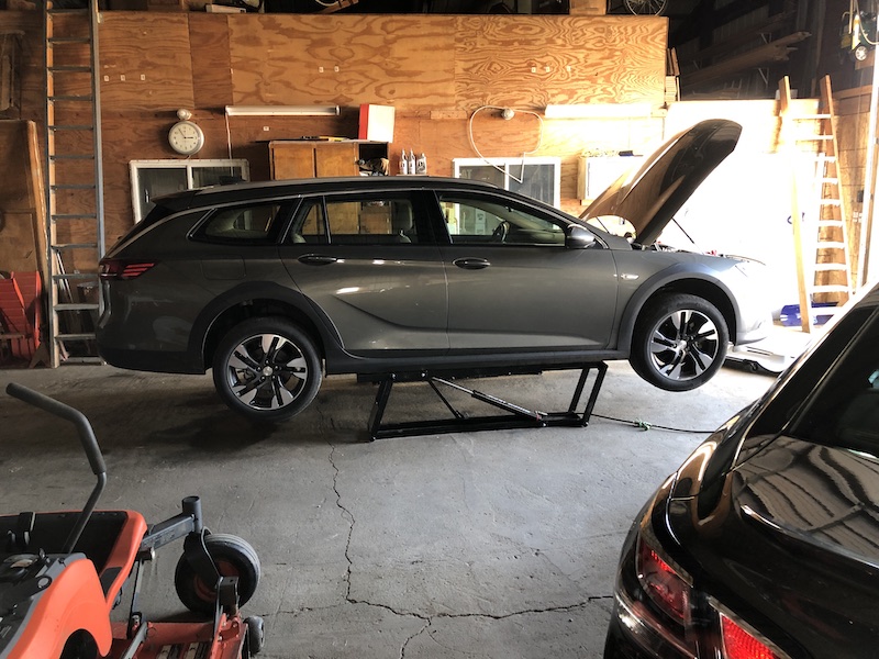

I have a set that I use on my wife's Buick Regal TourX, and that I used on my former Chevrolet SS Sport Sedan. Never needed them with my 2015 RAM 2500 4x4 (just it sold yesterday), as it sat high enough to roll underneath without jacking. My new (ordered) RAM Classic 4x4 will probably sit low enough that I'll need to use them.
They're not exactly quick to set up, about the same as jack stands and a floor jack, but I can get the car higher (and level), and they're out of the way for doing an oil change, so overall they're a win.
