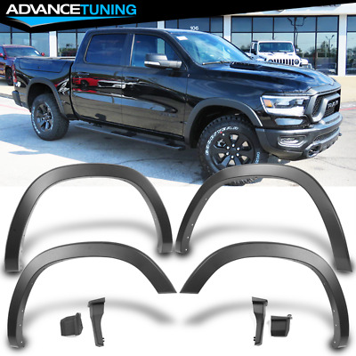

thanks for everyone’s help. I am looking at this set from eBay and it looks like it comes with new spats. I have emailed the company to ask but haven’t gotten a response. has anyone tried these? I will leave them black Thanks
