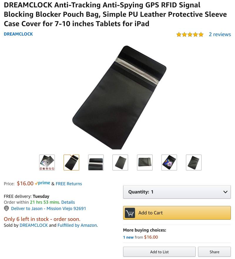

Get one of these its 16 dollars place a spare ket in the bag. Then stick it behind the rear rear passenger seat with a string. If anyone ever brakes into ur ride they will not find it an take ur ride
