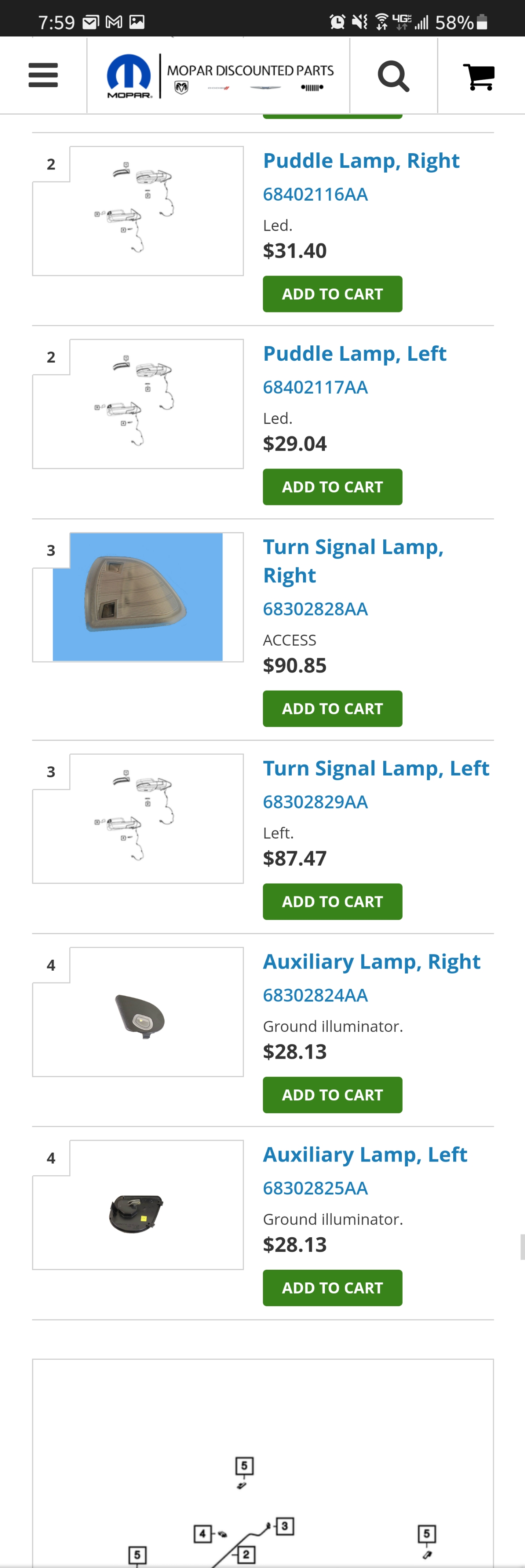

One more thing, anyone have a procedure for changing that puddle light? I’m not quite sure how to get into the 5th gen mirrors. Saw a couple YouTube videos, but they were all for 4th gen.
Ldc2335
Aug 16, 2021
310
502
Edited: the tow mirror puddles look like the pop out, but not the standard mirrors.
Guessing you can remove the mirror cap and look down in there. I believe if you tilt the mirror glass all the way down, you can slip a flathead in there and release the mirror cap via two clips.
Do not bend or put pressure on the top of the glass for leverage...it will shatter
