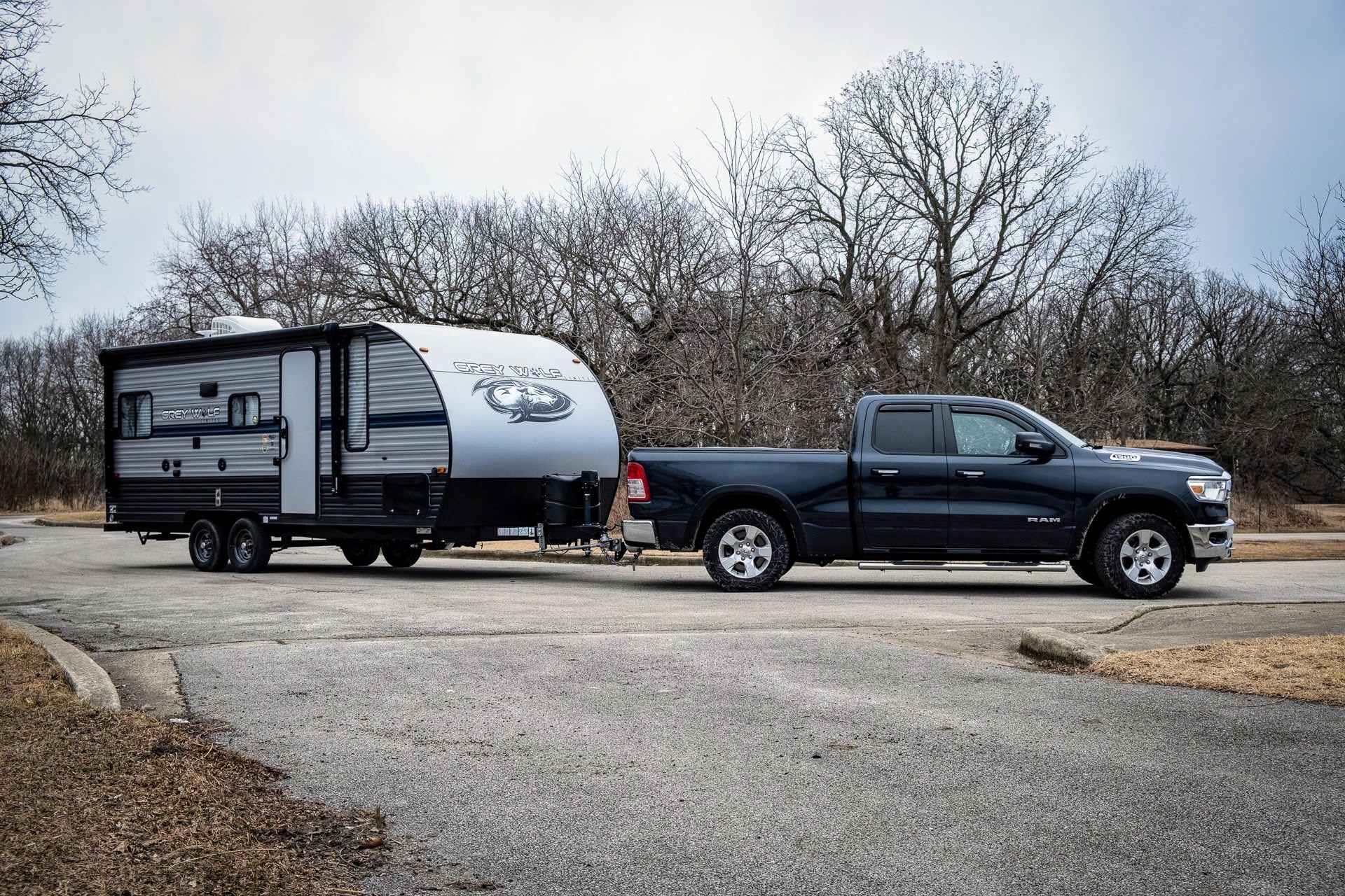

I'm towing this (23ft total, about 6000# loaded) for almost 2 years on the road, full time RVing. 35k miles and counting. I see temps very similar to what the OP showed. The highest oil temp I ever observed was 252F, transmission 197F, in the mountains.
