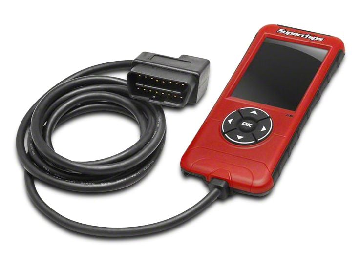

Ive been thinking about getting a tune or getting the SuperChips Flashpaq F5 Tuner.
I like the flexible to switch between eco and sport. But I also have the Tazer DT installed on my truck and I use that to enable my LED turn signals and LED rear lights, Plus auto folder my mirrors.
Does anybody know of a part like the F5 tuner that also has the same similar features as the Tazer DT? If not can a tune shop program the auto folder mirrors and LED lights to be enable?
My understanding so far is that I cant use the Tazer DT and the F5.

The part I dont understand is why the F5 tuner uss the SGW module along with the ODB port. I know I can get a custom tune and keep the tazer but that cost alot more then just getting something like the F5 tuner.

So the Tazer plugs into the SGW module. From what i saw on Superchips website there device uses the same port. Therefore you cant use both.
For one, the Flashpaq 5 uses OBD port, and secondly, you don't leave the Superchips plugged in all the time. Only when changing tunes.

I called americantrucks.com they have one thats open box and it show a part that plugs into the SGW module. When I asked the guy about it told me I would have to get rid of my tazer cause they use the same port. This is why im asking cause Flashpaq doesnt show that in there pictures on there site.

I wouldnt trust a guy from a distribution website, he obviously doesnt know much about the products. There is probably a SGW bypass, which the Tazer works as. And still, you dont leave the Superchips plugged in all the time. You cha ge your tune, or whatever other settings you can change with the Superchips, then you unplug it. Tazer stays on the truck if you want the live features like autofold mirrors.
Look at the picture, that an ODB2 plug.
You can't apply tunes via a SGW port lol.
I think you need to step back and figure to what you actually want to do before you go looking at parts.
You talk about switching between eco or sport, it sounds like you might be better served getting throttle adjuster like a sprint booster or the other several other units.
For what it's worth my 2022 has a custom tune, SGW bypass module, Sprint Booster, and I ran a TazerDT for 2 weeks before returning it because it literally doesn't work on a 2022 despite the manual claiming it did.

I just picked up Superchips calibrator to adjust tire size for the accurate speedometer speed. For 2019+ RAMs, it will come with Bypass Module that will need to be plugged into SGW port (you unplug the two wires and plug them into bypass module) to be able to get into the truck set up menu and then you plug in Superchips calibrator/tuner into ODB2 port to make adjustments.
Acdeals187
Jan 23, 2023
6
8
To add, I double checked with Superchips FlashCal and sounds like you only need to have Bypass Module plugged in, if you wish to make any calibrations/changes. Up to you, if you want to leave bypass module plugged in for easy changes with calibration tool or you can plug both wires into OEM ports and not to worry about it.
This is correct
