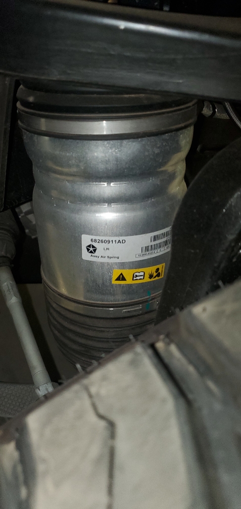

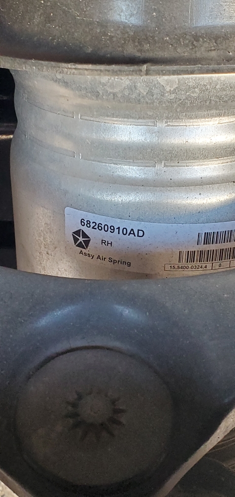

I was just curious and went to my dealer to check some part numbers. Found a Bighorn with OEM Mopar air suspension.
I found this part number on the front shock:

so the 910 and 911 part numbers as I posted above .. appears 911 is the Left side so the 910 must be the front right.
thanks @MannyHen for the photo!
