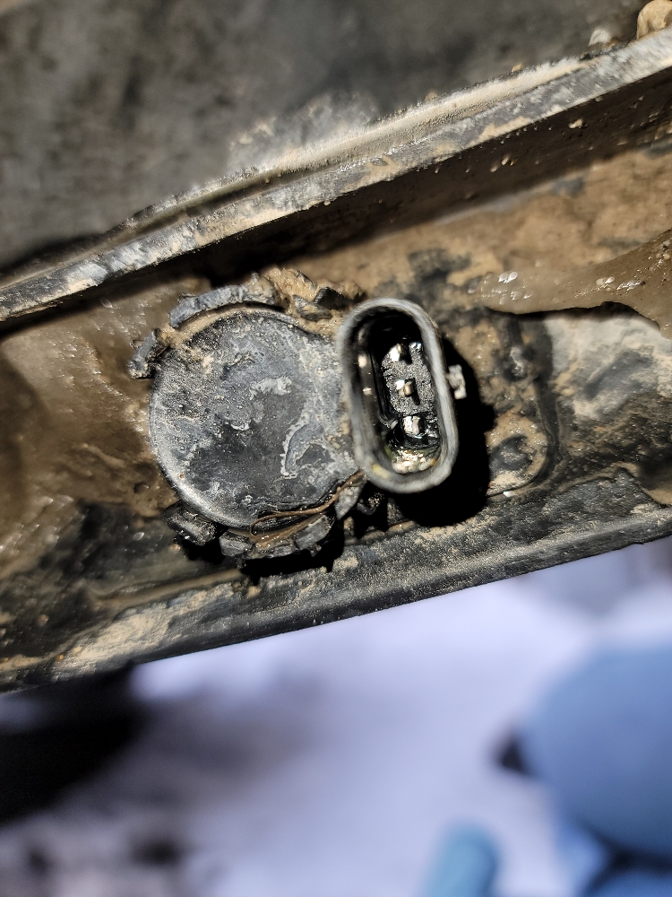

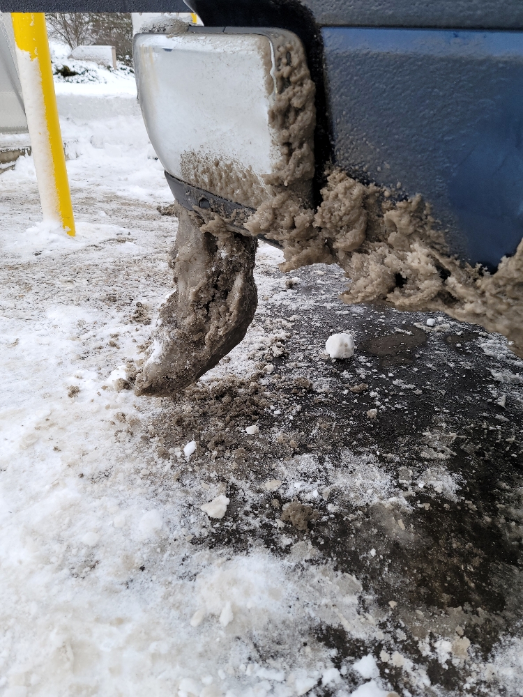

My rear park sense turned itself off today and said I needed service. I got out and walked around my truck to find this slush/ice ball hanging at a weird spot. Under further investigation I noticed it was hanging from a wiring harness. The chunk must have let go from the fender and stayed attached to the wires for the rear park sense. I took a blow dryer to it and freed up the wire which had a plug at the bottom of it and found the sensor it had come out of. I ran the blow dryer on both ends until they were dry and plugged them back together. My sensors now work and the service message went away.
Hopefully this was a one off and not something I need to worry about every time it snows.

You have mud flaps in there?

The sensor will turn itself off even without being unplugged. It takes a certain amount of dirt/snow to accumulate on it and it actually stops working, for safety reasons (it cannot measure accurately) It's pretty common.
Your problem, on the other hand, isn't.
Never seen one getting unplugged like this, but I guess it was a big chunk of snow so it just ripped the wires off...

Yeah, just from driving around. Thankfully the plug pulled clean out of the sensor. Once I used the hair dryer to melt all the collected ice out and dry each connection out it hooked back up and started working again.
I don't, just the little pieces of plastic that come from the factory. The one on the front was hanging off the other day as well. It was an easy fix to get back on the clips, I think the car wash knocked it off.
