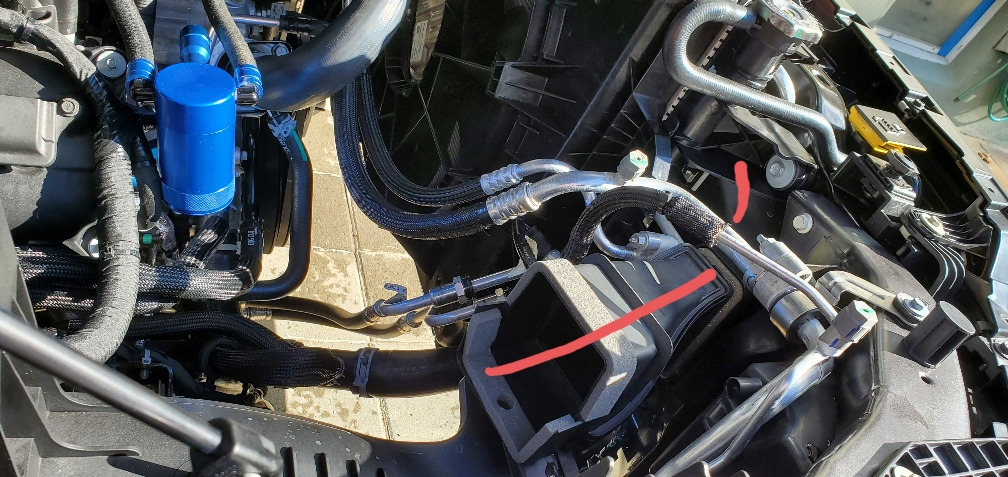

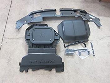

Here is another picture of the stock intake...on the Rebel.
When I removed the stock intake, it has this going to the radiator, and not downward.
2021 Ram Rebel
2016 Dodge Charger scat pack

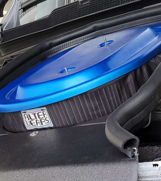

I would at least run a filter wrap that’s water resistant like Outerwears.View attachment 111348
You are right on... I thought about that right before I installed the vararam and I bought one. Here is a closer view.
I just think that maybe my ocd is just messing with me with this specific intake. I could check it after every offroading trip and see if it's dirty and just rinse it it's super easy to take off and put back on

FILTERWEARS Pre-Filter F270K For Vararam Air Grabber Intake https://a.co/d/1ZKGYLW
