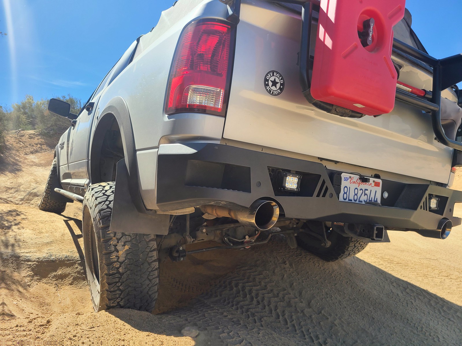

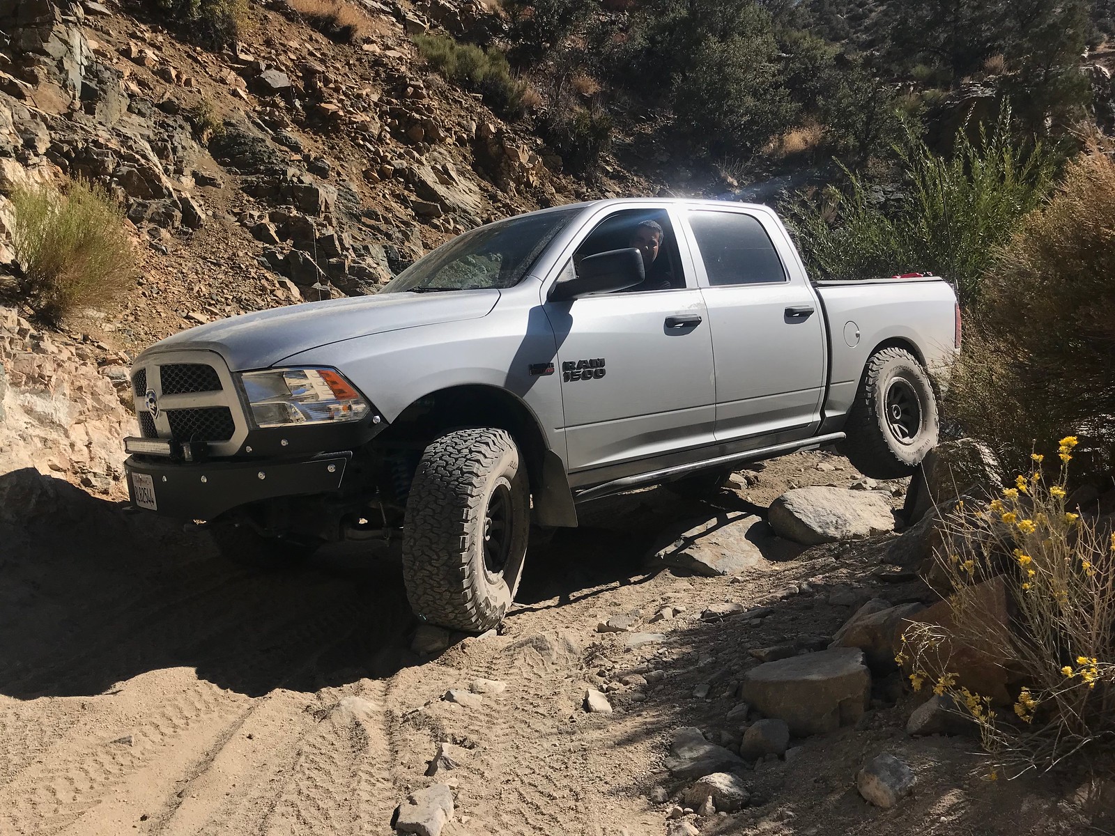

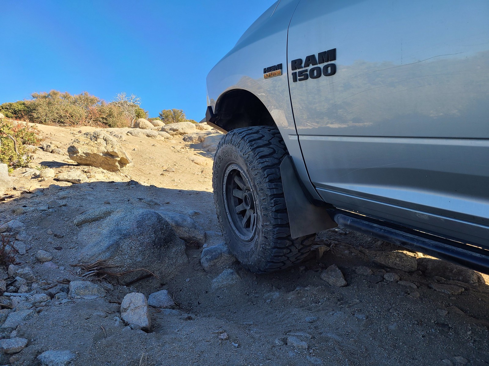

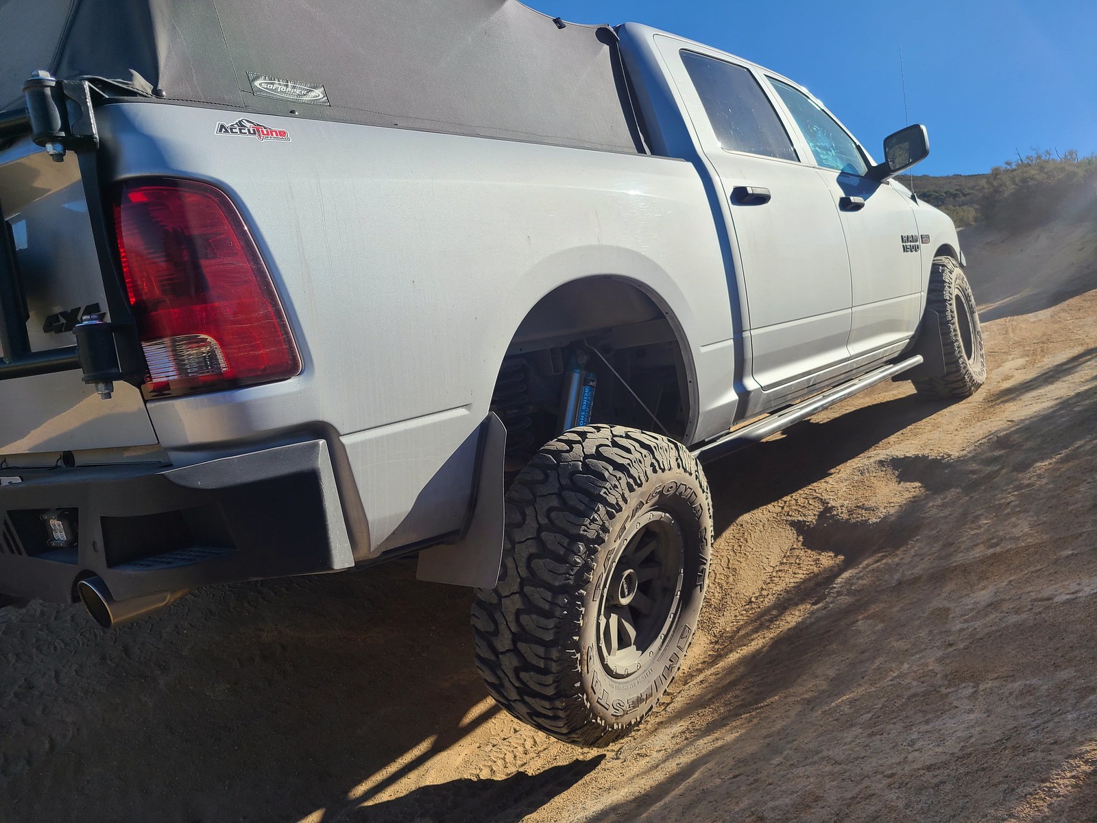

Some fellas have never seen off-camber trails in a 6" truck. Lol. i think the only benefit of a 6" lifted truck will be more rocker panel clearance, better approach/departure angle, at least if you're comparing stock truck vs truck.
Here in socal you can go lots of places if you get 2" more in the front and 1.5" rear, rock sliders, steel bumpers.. I don't have rear lockers cause I drive a 4th gen RAM 1500 and I've taken my truck many places with the factory LSD and factory brake locking diff. As long as you're not affraid to bang your skids/sliders she can go lots of places even more with a winch to get you out of a pinch. Ive ran 37's with the same setup but I'm back to 35's cause my offroading is a little bit tough sometimes and 37's are hard on IFS,MPG and acceleration,brakes etc. You guys have rear lockers now in the 5th gen Rebels and gas tank skids so your truck is more capable than you think on 35's, put a nice suspension with race shocks and aftermarket good UCA's and you'll have a very capable offroad truck that can surprise a lot of people.
This is my 2.5-2.75" liften 4th gen, you guys can go 3" easy. I don't like brackets anything and i don't believe a higher center of gravity will do me any good in the trails i run with a IFS and short arms IFS. ive put longer shocks in the back to have a little more reach when off camber. This is with 315/70/17 Pat MTs

I also like to run a little faster trails so being at 6" will hinder cornering, i really prefer a lower center of gravity for a lot of reasons.
