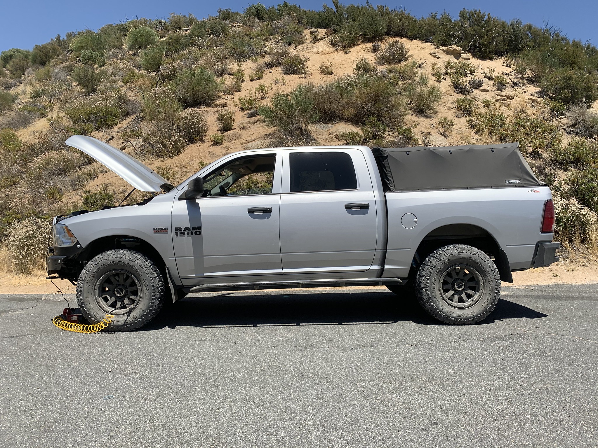

I use a Smittybilt 2780 2.54 CFM air compressor. I can inflate my 33" tires from 25 psi - 45 psi in about 3 minutes or so each. You need to either use the trucks battery (engine running) or have another 12v power source which I use my deep cycle trawler pack I keep in the bed. This pump was about $60 on amazon a few months ago, though around $90 now, still worth it. It comes with a long coil airlines, I can do all 4 tires with the pump sitting in the same location on the ground, I don't have to move it which makes it convenient.
On a side note, If you every plan to deflate tires for some off-roading, I use automatic deflators to deflate my tires to 25 psi (or whatever preset you want). I screw them on the tires and in about 1 minute all 4 of my tires are at 25 psi. It's a great combo with the air compressor.

Most recently in use with my Ranger at my local mountain truck trail........
