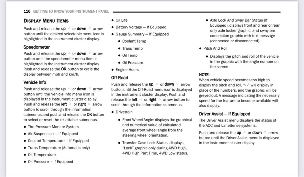

You have to select what you want to show in your DIC. Mine wasn’t set to default on.
If your truck has it. That is.
I scrolled through the dash cluster and apps on 8.4 screen and couldn't find the ORG pages. How do we know if our trucks have it?

I don't think the Big Horns get off road pages. Rebel on up do. Or you can enable with alfaOBD.
Mine has it, 2021 Big Horn Level II. No special programmers or adjustments. It's been there from the day I drove it off the lot.

Standard on Rebels, or with the Off Road Group.
It should be standard if you know how to use ALFAOBD.
It should be standard of you know how to use ALFAOBD.
Doesn't work on UC4. They will disappear after a day, and half the functions don't even work when they are visible. And UC4 doesn't display them in guage cluster. I had them on my 2020 until I upgraded software past the 39.7 firmware. .
