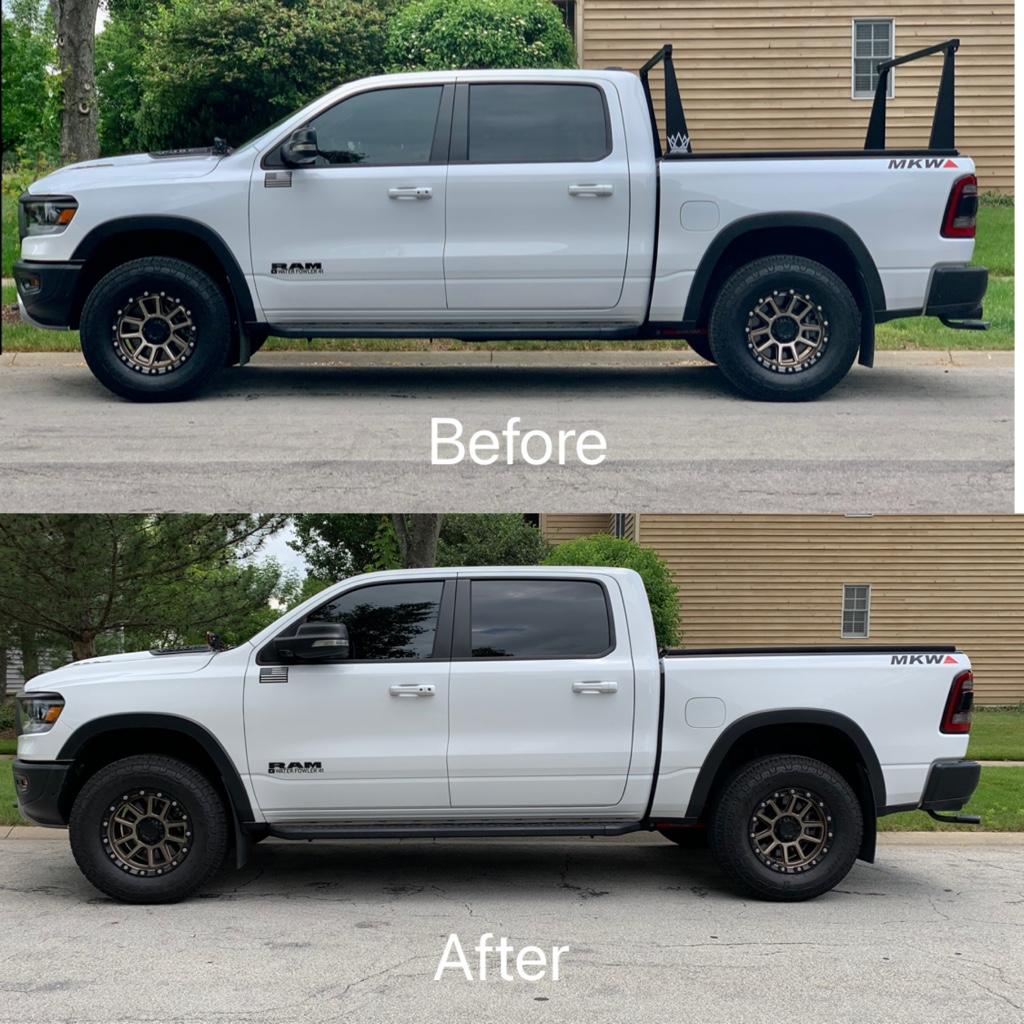

Here are my before/Afters. 2021 Rebel
Before: Factory Bilstein 4600s, ORP
After: Bilstein 5100s setting 5, RL UCA, Icon +1.5" Rear Coil Spring
I put a few hundred miles on it this weekend and it is pretty damn close stock ride. If I am looking for something, i feel like the back end feels slightly looser going around an exit ramp etc. but this could be me digging for something, I only had a few hundred miles on the truck total before this switch. So far I am happy.
View attachment 90304 View attachment 90301 View attachment 90302 View attachment 90299 View attachment 90303 View attachment 90300
