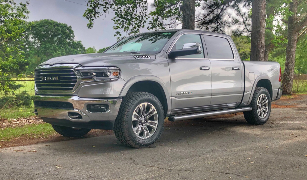

I went with 295/60/R20s on my Longhorn with ORP...fits great no rubbing! They are basically right at 34” and a little over 11.5 wide

I had some 285/60/20 Toyo Open Country AT's installed yesterday. Longhorn with ORP. New Fuel Wheels with OE offset too. They rub the molded splash guards. I will need to trim them a bit. If you intend to use the same type of splash guard, keep this in mind.

That's very surprising. What offset are you running? Are you sure it is the same as stock? People have been putting 295/60s and 33x12.50 on stock wheels with no rubbing.

They only rub the splash guards. Are you sure that others have the same molded splash guards installed?

Wow that’s really close, how is it when you hit those bumps ?
