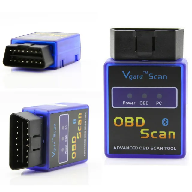

I also have a Vgate Scan adaptor. I think I had this one for my Silverado, so it's even older yet.
Vehicle-Diagnostic-Tool-OBD2-OBD-II-Vgate-ELM327-Bluetooth-OBD-Scanner-Diagnostic-Scanner-Work-With-OBD2.jpg_640x640.jpg

You can try AlfaOBD free in read only mode without a bypass cable. You won't really know if you can write values until you try. Those older devices may not even be fully ELM327 compliant.
It doesn't look like the OBDEleven is a generic ELM327/OBDII reader and it only works with their app.
The generic ELM327 readers will work for most things, but not everything, and the older/cheaper ones tend to also be to slow for any data logging or real time displays.
