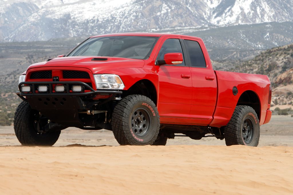

Not sure what the OEM wheel travel is. Saw someone on the Ram forum say 6" in the front and 9" in the back. That sounds more passenger car than off-road. That a 34" fits at normal ride height is amazing. The TRX I believe uses a Dirt King long-arm suspension and FibrewerX fenders to fit 37s; I believe the tire adds most of the lift with 13" of travel. Dodge used to sell the suspension and fenders as a prerunner kit. The one on the left is a 2019 from the FibrewerX site, on the right a Prerunner kit.
