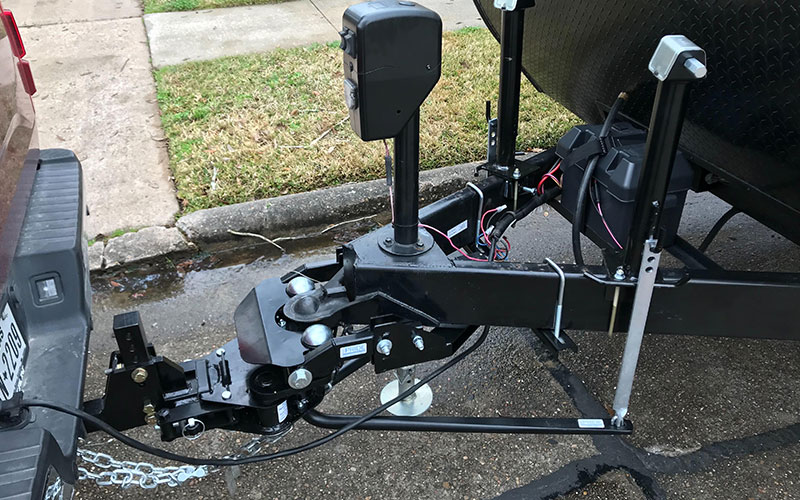

Have you considered a Hensley or ProPride Hitch? They are 4-bar linkage, effectively a virtual 5th wheel. After getting it tractor-trailers and the tall divider wall on I-476 went unnoticed. On one trip I blew a trailer tire and didn't notice until in my driveway with just two little rings of rubber on the wheel.
This is a ProPride. I have a Hensley since ProPride didn't exist then. I think there may be other brands now also. Not cheap ($2400-$3000) but IMHO worth it.

The point is the Hensley/ProPride are close enough to a fifth wheel you never notice.
