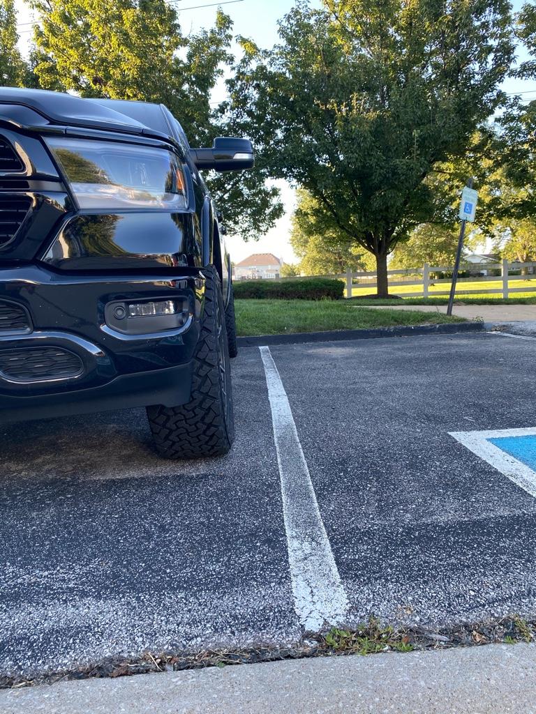

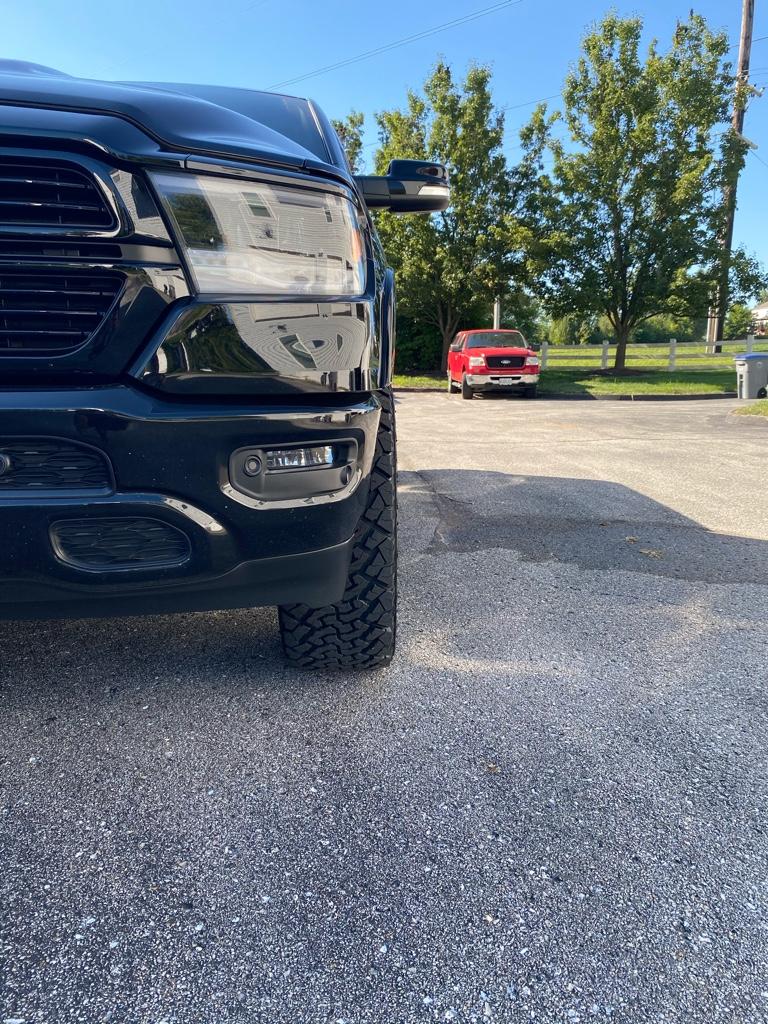

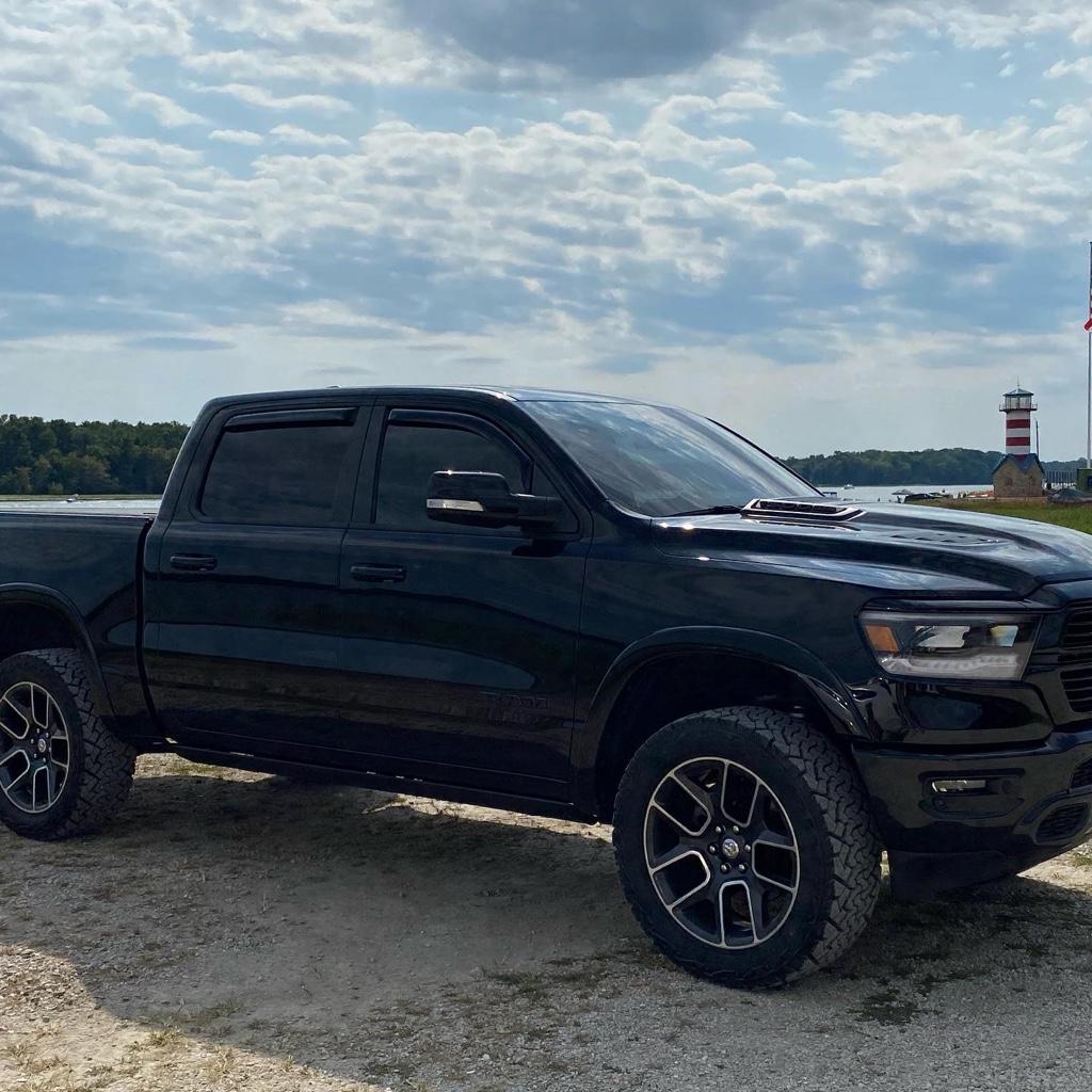

I just did the RL SST 3.5 and 35/12.5/22 setup.
I kept my factory rims because the black and silver go well and didnt need to spend the extra cash.
I did add a .25” (1/4) rough country wheel spacer just to make sure I didn’t rub. Being the EOM wheel is +19 offset adding the spacer only put me .4 closer to the new upper control arm.
I drive 60 miles a day to work and the road noise isn’t bad with my Venom Hunter XTs

Was curious about the Venoms. I went with the RDR M/T which is a 10ply they are a bit noisy and stiff so I will probably switch soon A6B456A3-140C-41A6-9DDA-C87E2DA52EC8.jpeg
