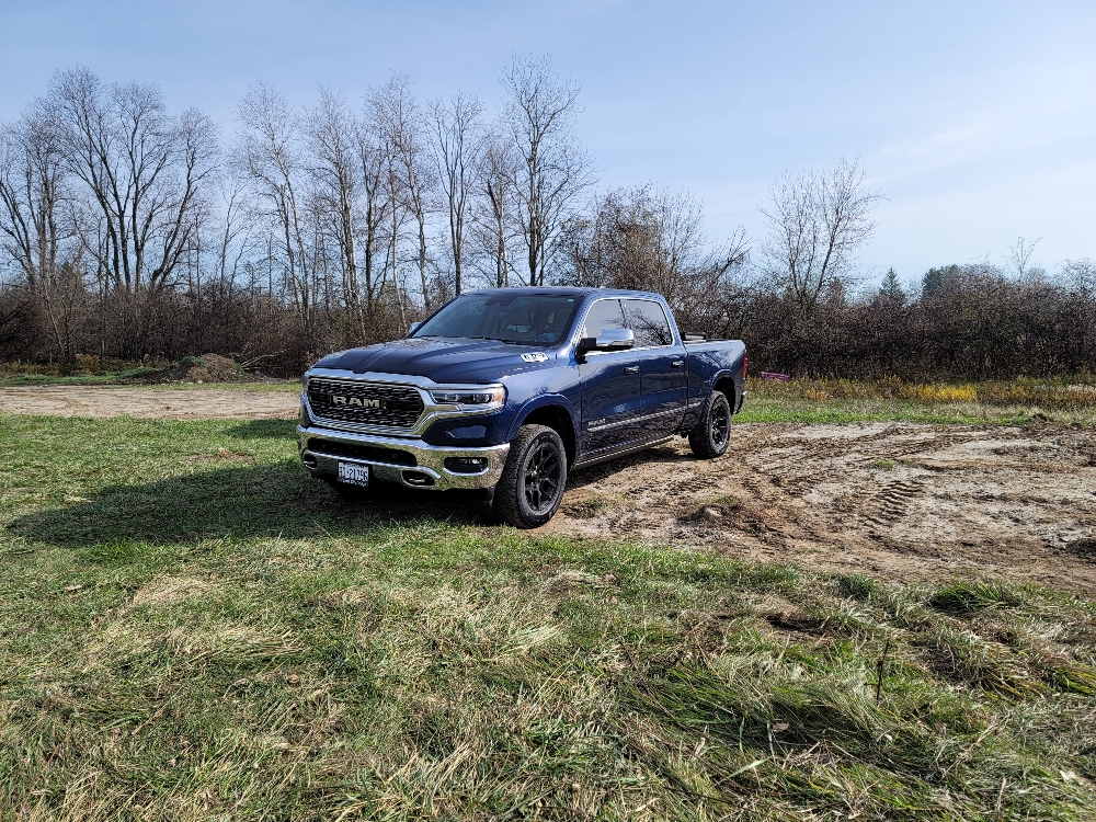

Installed and enjoying the look and ride of the winter setup. ❄️🇨🇦🏔️
