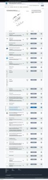

Thank you guys! Right now I'm painfully building this truck up. First I got put on a new tonneau cover, and then I swapped the factory tires with Falken Wildpeak AT3W. Just bought a headache rack from Canadian Tire and a pair of tow hooks from Amazon. Now I'm looking to put a set of skid plates on. I'm leaning towards mopar plates, but the fuel tank plate and parts are really confusing. If you have the factory plates, would you tell me if I need fuel tank plate cross members? Thanks!
These are the part numbers for the skid plates that I installed. Front and Trans plates. I’m still waiting to do the gas tank skid. From my understanding, the cross member is needed. If you find part number for the gas tank skid and cross, please share!
I just put mine on this is what I ordered and you need a couple of bolts
06512090AA​
2
$ 3.80​
Used for: NUT AND RETAINER. Hex Flange Lock. M8x1.25.
06512090AA​
$ 3.80​
68303523AB​
$ 36.92​
BRACKET. SKID PLATE.
52029963AD​
$ 280.24​
SKID PLATE. Fuel Tank.
[26 Gallon Fuel Tank] OR [23 Gallon Fuel Tank], [Fuel Tank Skid Plate Shield].
My tank is 33 gallon. I used this diagram as my reference...just found it.
