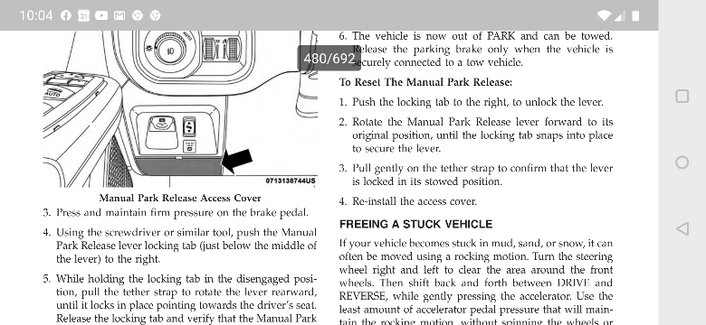

Anybody have an idea what this does ? Right under the Ebrake on the bottom left

Probably puts the truck in neutral if the battery is dead

For those don't like to read the manual
