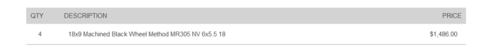

I dont have a part number. Below is the best I can provide you with. I was struggling because the -12 offset is not the look i wanted. that pushes it out more than a full inch and I really didnt want the tires outside the fenders.
