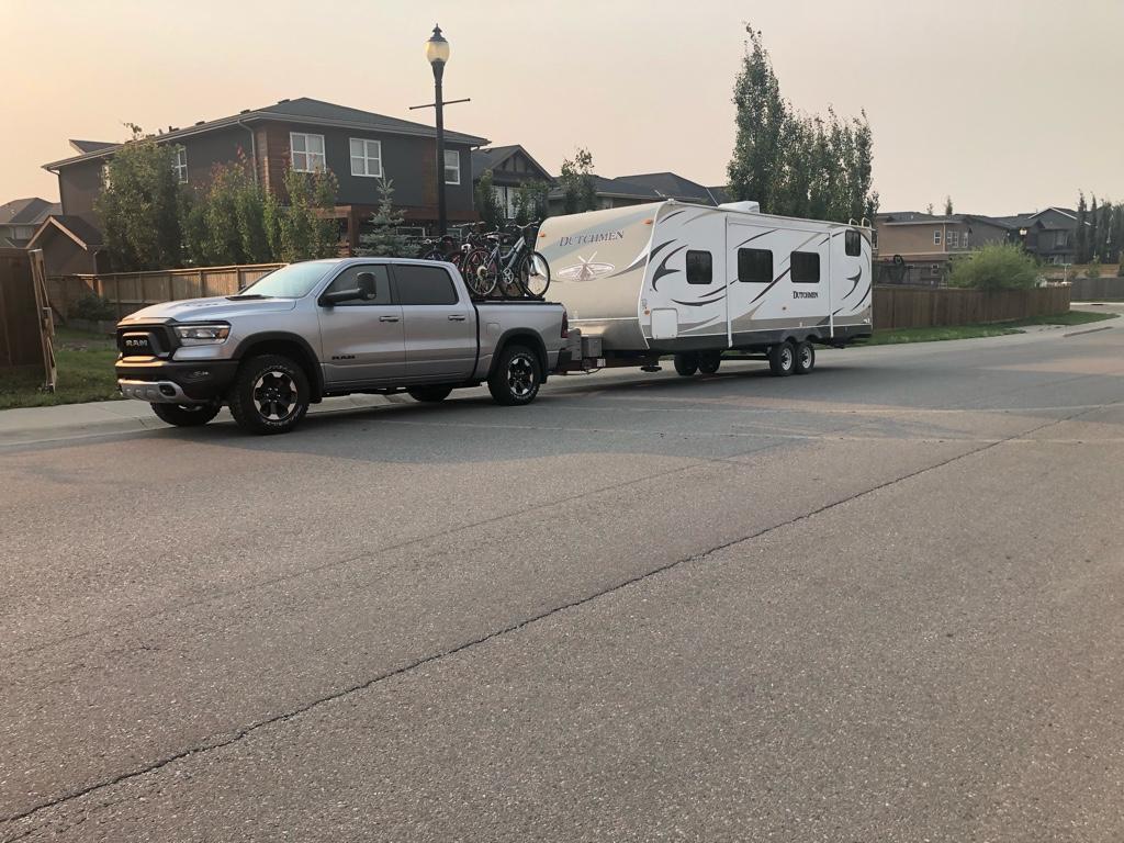

We did about 12,000 miles with a 31’ long, 5200 lbs dry (~6,500 lbs loaded) before upgrading to a 33’ long, 6800 lbs dry (~8200 lbs loaded) camper.
I feel this is the limit of the 1500
DD114437-85C7-4F76-838C-7681EBB347CD.jpeg 4B5E1CA2-CB93-497F-A5F0-46373E1BDEA5.png
View attachment 105143 View attachment 105146
33 box or total length? How did it tow? Cause I believe those numbers are comparable to the 2970RL I was looking at and prefer. But I agree that is probably the maximum while still being safe(from what I've researched and have been told)
IvoryHemi
Jan 3, 2021
1,525
1,532
box is about 30’, as overall is 33’
