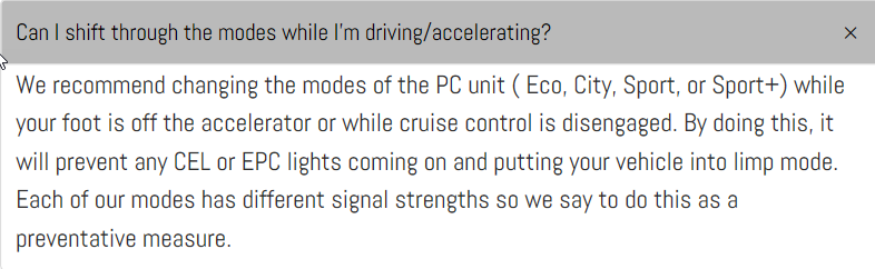

Apparently scrolled thru the options on my bluetooth pedal commander too fast and dash error lights lite UP like a Christmas tree and there was close to zero throttle respone....pulled over, shut her down and then restarted and everything was back to. normal.but with a check engine light. This is the second time PC has thrown that code, right after my install and now this....least that's my hunch. As soon as I can find the OBD port I'll know more.....

I have read similar stories when changing PC on the fly. Which PC do you have?
You have the pedal commander with latest firmware for ram so I suspect it may be trying to change while accelerating.
From pc website :
From pc website :
And there it is....appreciate it
