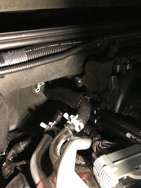

I would think the big hose goes to the radiator. Any other small hoses? My Jeep has the 3.6. When my son comes home with it I’ll take a lookThis are the 2 hoses that comes out of the water pump one is thicker than the other one
I only see the one small hose and the big radiator hose as well. Not sure if the small one is outlet or inlet because it goes underneath. The skid plate blocks my viewThanks
I mean, that's not where I said.
Oh sorry i misunderstood. So you’re saying to follow the heater hose back from the firewall to see where it originates?I mean, that's not where I said.
You can put the valve anywhere in the line where it's just the rubber hose. Just have to cut the rubber hose. Which means either hose coming off the firewallOh sorry i misunderstood. So you’re saying to follow the heater hose back from the firewall to see where it originates?
Here is a picture shared by someone else in the "what did you do to your RAM" thread. Shows where he put the valve, but it could have been installed in either of the hoses in the picture that are for the heater coreOh sorry i misunderstood. So you’re saying to follow the heater hose back from the firewall to see where it originates?
Yes I see. That’s how I did my hack on my hemi. The question is where to do it on the pentastar 3.6.Here is a picture shared by someone else in the "what did you do to your RAM" thread. Shows where he put the valve, but it could have been installed in either of the hoses in the picture that are for the heater core View attachment 184972
The heater hoses are in the same spot on the firewall. Shouldn't be hard to figure outYes I see. That’s how I did my hack on my hemi. The question is where to do it on the pentastar 3.6.
