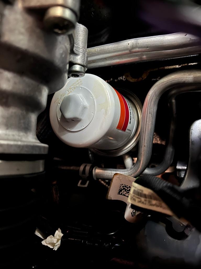

I picked up these square drive socket caps on amazon i believe and thought id give them a try when loosening or snugging up my oil filter. I usually only go hand tight but even that can be a pain with the location of the oil filter on these trucks. Just tried it out and it worked like a charm! Figured id post some photos of them to help anyone out that has trouble with them.20211108_152407.jpg

Another easy option, but a filter with the aviation type end nut

I found that the filter is only an issue for the first one, and only if you change it cold. Getting my truck to temp, waiting 15 minutes and doing the oil change, I found the original factory filter easy to remove.
After that, you should only be hand tightening the filters, and they should be a piece of cake to remove on future oil changes.
SRT oil filter here, through the front. No wrench needed to loosen...mainly to keep from searing your hands on the 220 degree oil filter
