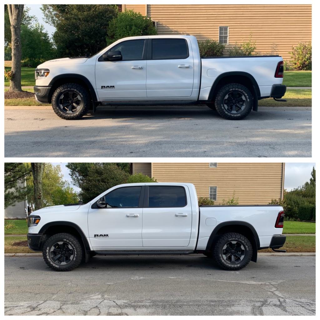

Installed the DR-2 kit from Motofab on my Rebel last week and wanted to provide some thoughts. This kit should give me 2” of front lift.
Installation:
The overall process is straight forward, the upper ball joints can be a pain but with a big enough hammer they’ll pop out eventually. Video below walks through the install. For basic leveling kits I prefer the top hat style spacer because it’s easier/safer to install.
Ride impact:
The ride was not impacted enough for me to notice. I’m still running factory UCAs for the time being.
Final measurements:
With the 2” level up front I gained a real work 1.5-1.75” of lift so I still have a 1/2” rake which is a-ok with me. For those looking to go to a 2.5” kit, you may be nose high.
Aesthetics:
Love the look and this should satisfy me until I can pick up a more completely 2.5” lift kit and tires.
