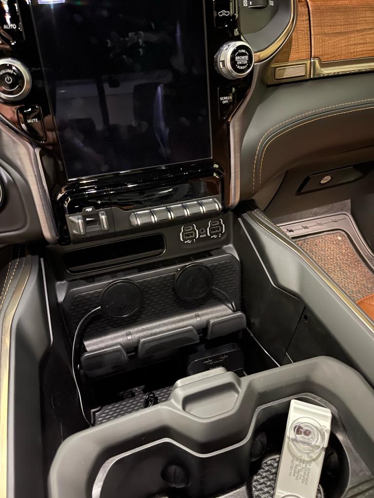

I have no issues with the wireless Ram charger and would definately have installed it if the truck did not come with it. I use a Samsubg Galaxy S7 with an Otter Box case and no problem charging.

I actually ordered the wireless pad to install, but sent it back. I had a previous year ram with wireless and it was a pain placing my phone just right on the pad. Sounds like it’s 50/50 that it stills performs the same way. Anyways, got a couple MagSafes, painted them black. And Velcro’d on. Don’t really notice them there since it’s so dark in the console. The iPhone just snaps into place to charge.
