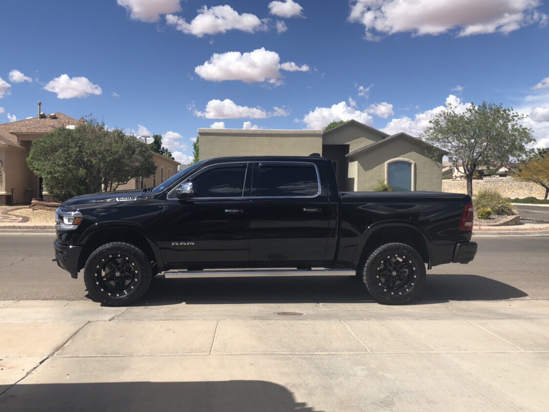

When did you purchase your Mopar lift? I believe if you got it within the last few months they should have provided the updated lift. If not they should still give you the spacer for free. My truck is not the ORP. To remedy the rake, I added the ORP springs for the additional inch along with the Mopar lift. Gave me about 3 1/2” up front. Still has a slight rake but less noticeable

The angles looked pretty good. Even asked the installer and he said it was good to go. I’ll take pictures when I get my truck back. It’s getting lined with Linex on the exterior

Skol, I like your setup. Looks good! Seems like a good solution. How does it ride with the ORP springs up front and Fox shocks? Thanks!
Appreciate it. I honestly couldn’t tell the difference. I’m sure their is however to me it’s pretty small. The tires however did stiffen up the ride and hurt some MPG’s. Nothing that worries me though. This is definitely the first truck I’ve had where the combination of lift and tires didn’t really affect my ride quality not the point where is could see a big difference

You're truck has the exact stance I want for my truck. Looks Amazing!
