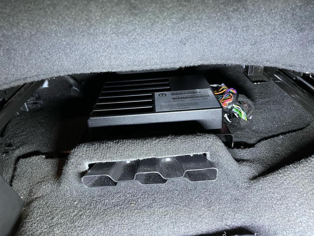

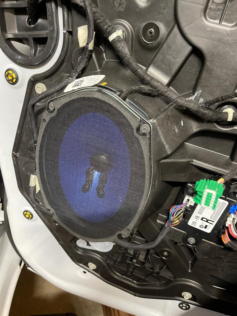

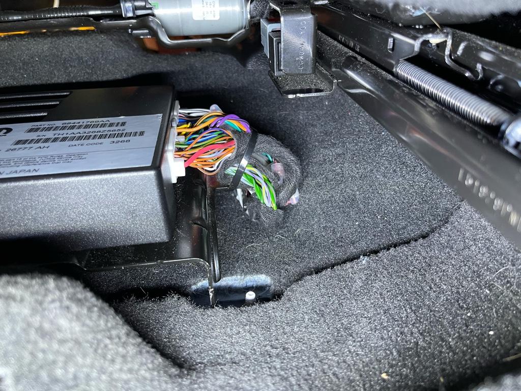

Just completed the majority of my base 6 to Alpine upgrade. I still have to get a sub. I don’t plan on doing the rear two in the headliner.

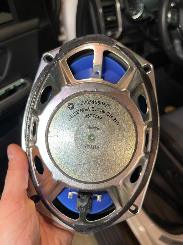

You were correct with the rear doors being the same as the alpine system. 05064378AB.

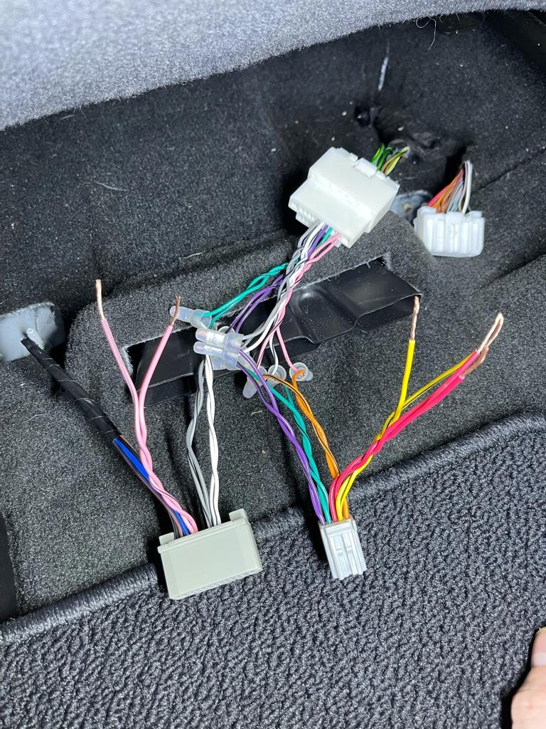

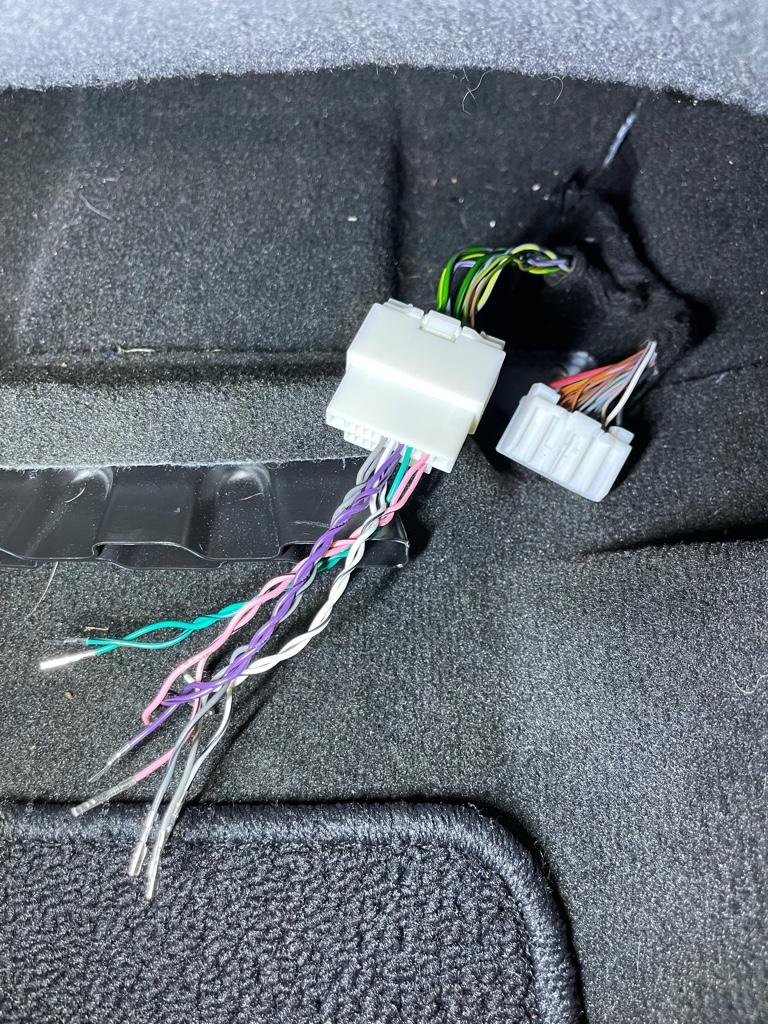

I also used the PAC APH-CH03. I didn’t want to cut any factory wires. I de-pinned the factory connector and pinned them into the unused white connector from the PAC kit to make an adapter. I added pics.

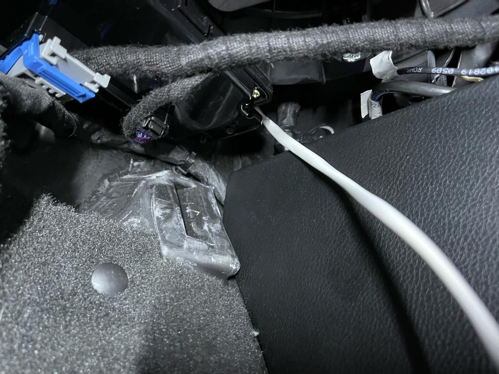

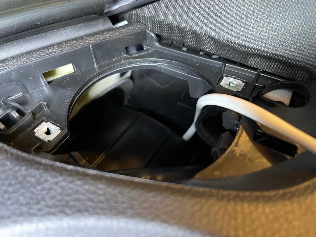

The wiring for the front dash speakers went really smooth. Some people said the passenger was a pita but I had no problem. I started from the top and hugged the outside edge and the wire fell right down. See pics.
I put infinity’s in the dash instead of oem. I replaced the front door speakers with the 05064378AB. What was in there was 52851560AA. They look the same. I will check the resistance.
It sounds decent. One thing is the front door signals seem to be low frequencies like a sub and not full range or mid/low. The rears seem to be full range. I’ll see if I can figure out the cutoff with an RTA. It seems odd. Im definitely using the front signals out of the amp.
Nice Job Trav... after the settings change you do loose the full range of the front doors.. again, only the dash and sub gets amplified. When you are shopping for the rear sub, you got to use the Alpine ver... triple coil. Once you add it, the system does wake up a bit... Like you stated, it does sound well for an OEM system.. Thanks for the pics...
