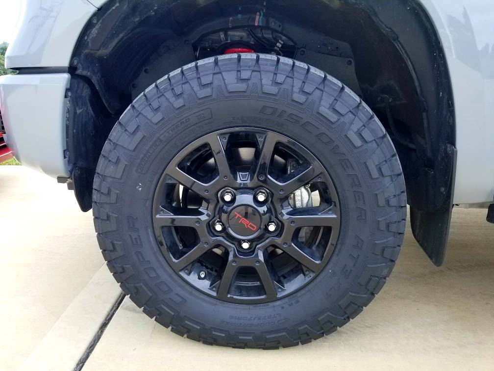

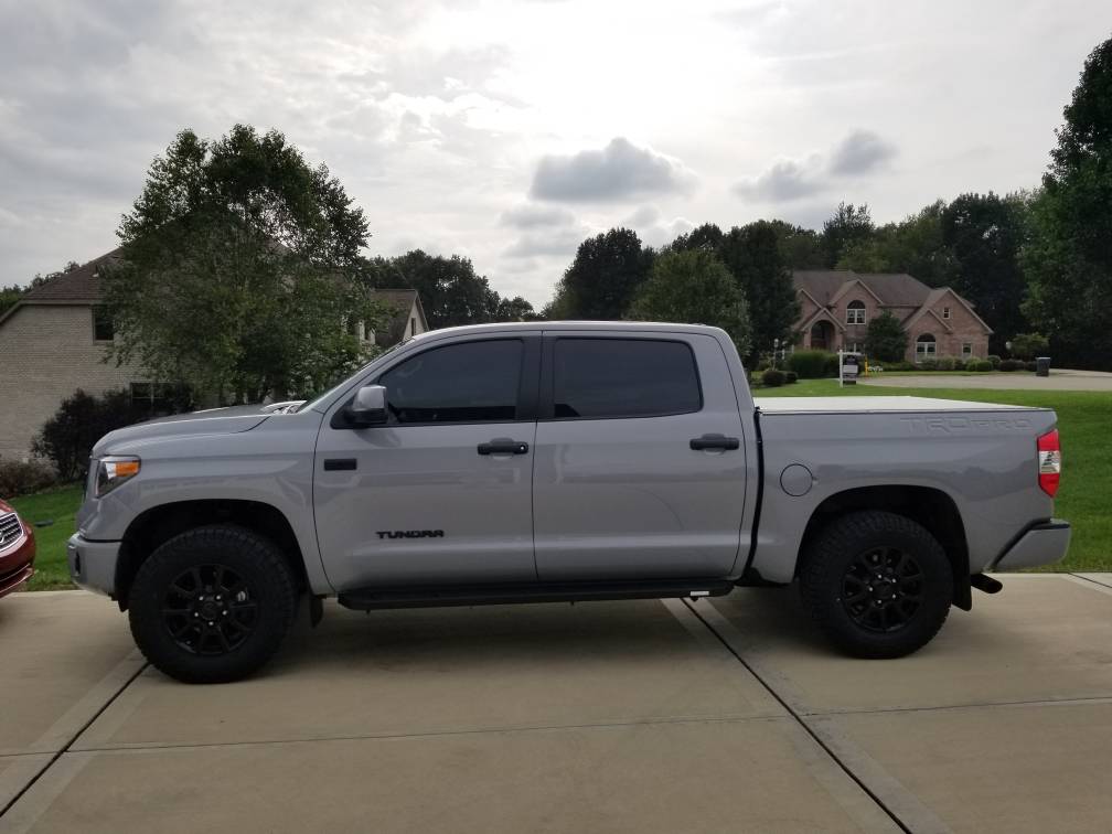

Check out the Cooper Discoverer AT3 XLT which is hands down the best A/T out at the moment IMHO. They are E rated. I came from the Tundra community most recently and they hit like wild fire over there last year.
Super aggressive looking sidewall, nice tread and very smooth / quiet ride. Way better than the Duratracs on my current Rebel.
