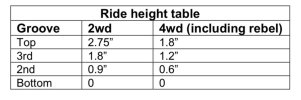

Here are the instructions.
My mechanic told me after he put them on that we could go higher. My truck is perfectly level right now. If I go to level 4, it should add essentially another inch, correct? I’m confused on the 2 vs 4wd settings below as the truck is obviously a 4wd.
Did he tell me wrong?

I am calling Eibach for clarification. Not sure why it would be different for 2 or 4 wheel drive. Bilstein and others do not have separate settings.

Seems like a logical fix. Did not mean to hicjack the OP's thread. From what I understand from reading other places, Eibach changed their install instructions and strut settings in the past year or more. Weird.
I will look for some ORP gem springs.
