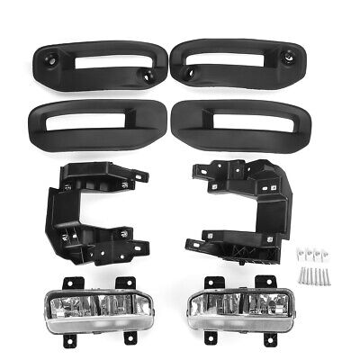

i have a 2019 with the led fog lights. i hit a deer and it broke the bracket that mounts to the truck that holds the fog light does anyone have a good part number / place to buy. Im only finding the regular housing non led

Complete Kit.

It just so happens I replaced my factor LED fog lights with aftermarket fogs (which required using the halogen housing), so I've got these parts removed.
There's four pieces: left and right side, and the trim piece you see from the outside, and a mount behind it. These are the part number from my 2021 Longhorn with parking sensors. Unfortunately, I cannot any legible numbers on the trim pieces, but these are the numbers for the mounts.
Left side mount: 68291439AB
Right side mount: 68291438AB

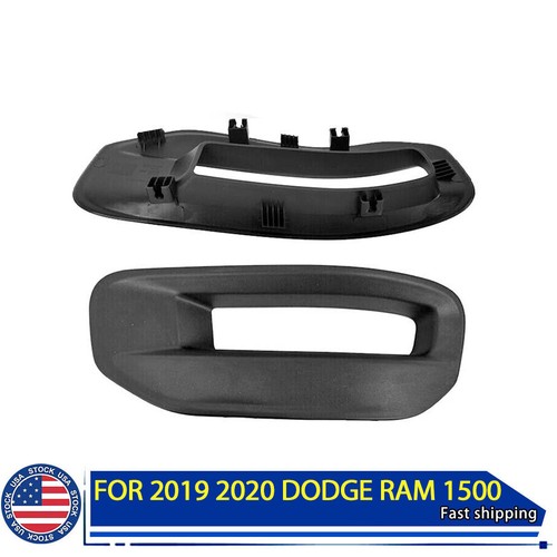

I just noticed that those do not have the park sensor covers. I'll look and to if they have a set with the park sensor covers.
As far as I know, they come with 2 sets of covers, sensor or no sensors.
To make sure they have sensor holes, you can get those.
