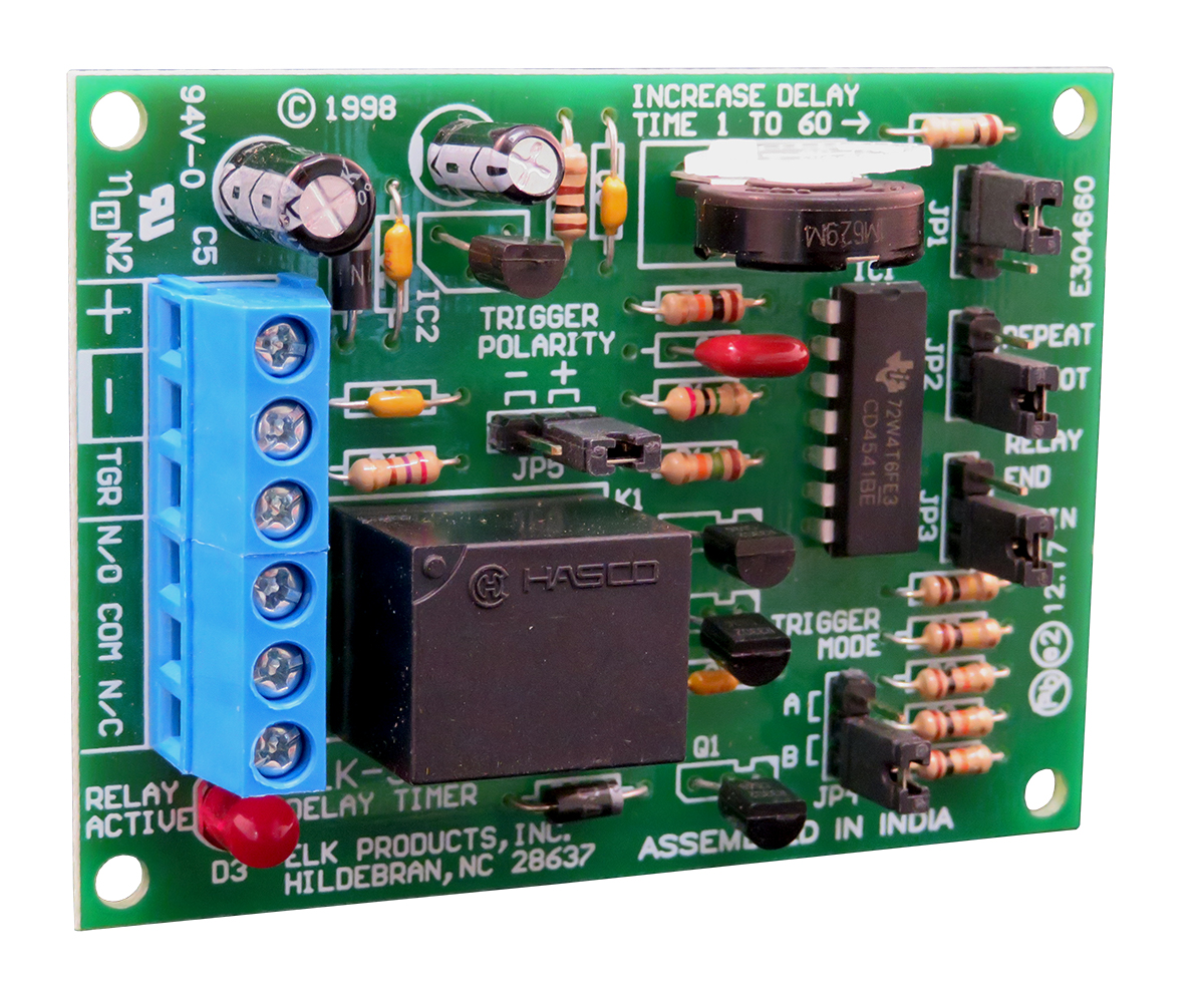

You could try something like this (link below). I have used the ELK timer relays on my older Harley’s that I retrofitted with HIDs to keep the headlight off through the ignition cycle/start to prevent damaging the ballasts. This was all before we had LED technology. You can easily set the time delay via a rheostat on the PCB for power on or off (normally open or normally closed circuit). You can find small plastic enclosures on Amazon to enclose the PCB and wiring too.
